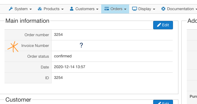

When using the HikaShop eSelect/Moneris payment plugin
Order number is recorded bu
Invoice Number is NOT recorded
Please advise.

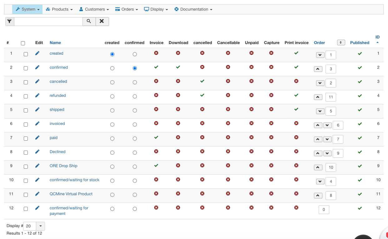

The invoice number will be generated based on how you configured the order statuses in the menu System>Order statuses.
So I would recommend to check that area.
If you don't find the problem, please provide a screenshot of the System>Order statuses listing and one of the settings of your payment method so that we can better understand the situation and tell you what to do.

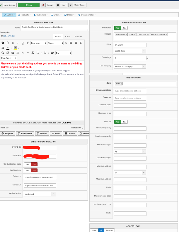

Hello Nicolas,
I checked the settings- please see screen shots.
The setting to trigger the invoice creation is set to on "Confirmed" in the STATUSES
Verified status in the plugin is also set to "Confirmed"

Thank you Philippe,
The status of Orders created and paid via eSelect/Moneris are automatically set by the plugin to 'confirmed'- you can see this setting in the above image.
