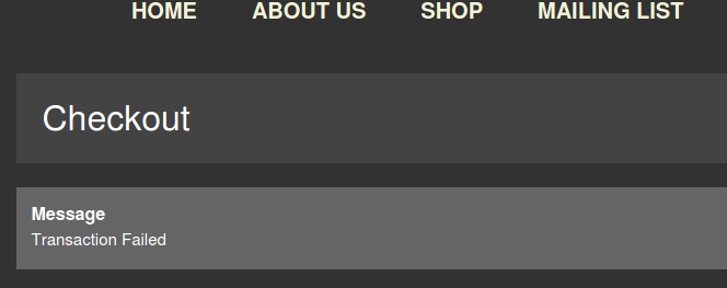

-- Error-message(debug-mod must be tuned on) -- : Transaction Failed

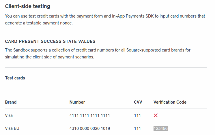

Hi, when you use a card that requires SCA such as the Visa test card here developer.squareup.com/docs/testing/test-values , the payment fails and an error message comes up saying Transaction Failed.
I initially thought this might just have been in the sandbox mode but yesterday a customer had this issue on the live site too.
I switched on the debug mode in the dev site and ran a sandbox test and received this error code from the api: CARD_DECLINED_VERIFICATION_REQUIRED
Is there a problem with the plugin or my configuration?
