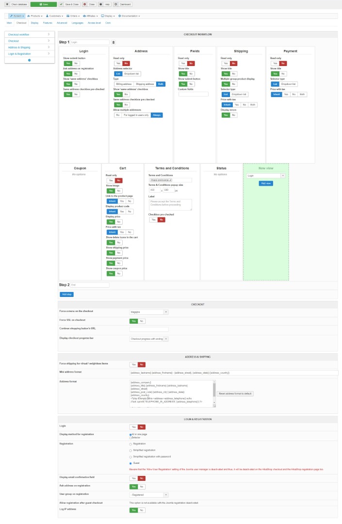

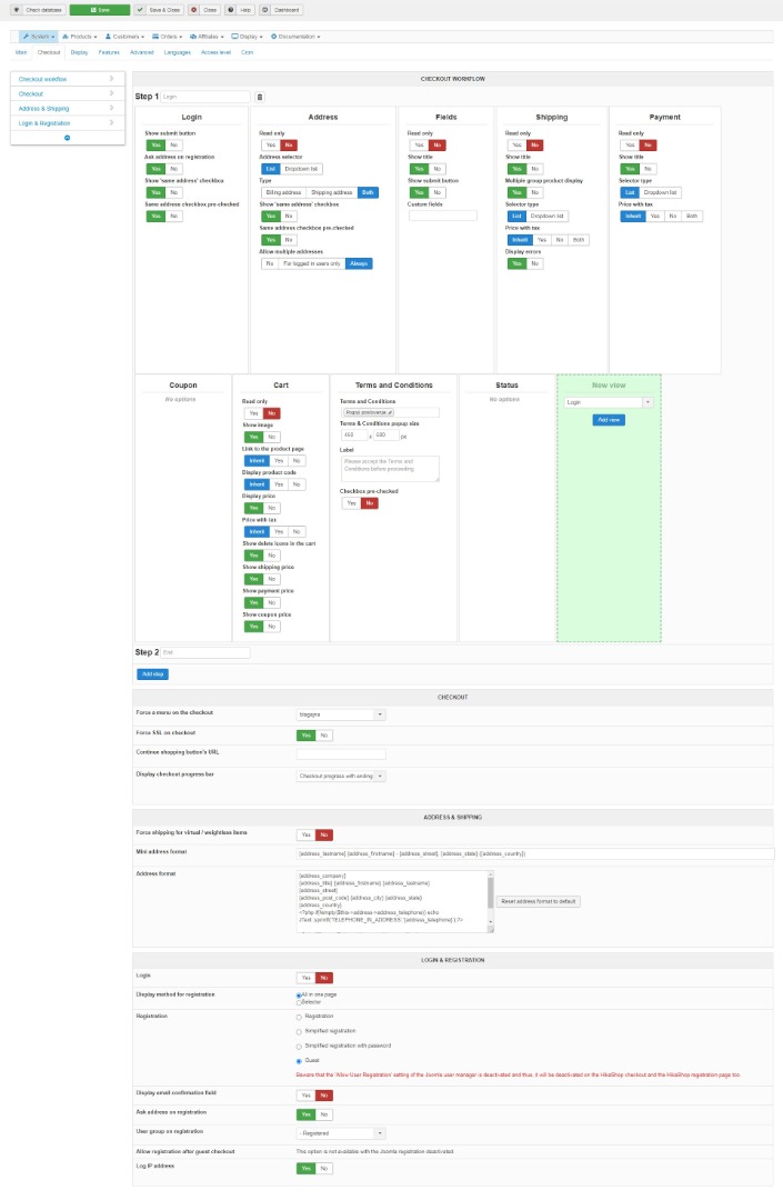

I might be a side effect of the "checkout" mode.
Do you have the same issue if you're in "end" mode ?
What is your HikaShop checkout workflow configuration ?

You're in one page checkout.
I suspect that the payment form is displayed when the billing address is not yet available.
Since the Stripe JavaScript is not refreshed if you change the billing address ; when you got the Stripe payment form, it's possible that it contains no address details.
I do think that having 2 steps should avoid the issue ; but modifying the plugin in order to perform a refresh of the Stripe payment form if you change the billing address, it might have some unwanted side effects.
But it might be a solution to update the Stripe Customer object via API just before trying to confirm the Payment Intent.
