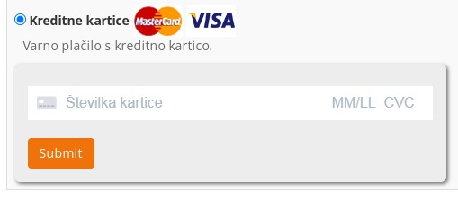

OK. I installed beta version and try checkout payment mode.
It loads in Iframe and it is very poor designed. Most of the elements cant be designed.
There is a button "Submit" and I cant translate it.

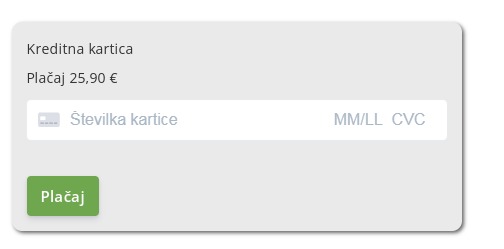

3 years 11 months ago #345649
I manage to somehow design the look.
But submit button cant be translated.
This is end page mode and translation is working.
  • Posts: 26389
  • Thank you received: 4078
3 years 11 months ago #345650
Regarding your screenshot, that orange button is the HikaShop checkout payment button.
So it's using the "HIKA_SUBMIT" translation.
For more details see the view : checkout / show_block_payment
