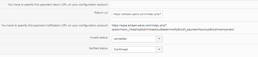

I don't understand what the address for 'You have to specify this payment notification URL on your configuration account' refers to, is this the address that SumUp needs to know?
Again, sorry for asking question that may not be anything to do with HikaShop but I'm so close.
  • Posts: 86177
  • Thank you received: 14212
3 years 1 month ago #353433
Both point 1 and point 2 are probably because you didn't do "You have to specify this payment notification URL on your configuration account".
After a payment, the payment gateway (Sumup in this case) usually sends a payment notification to the website. For that the payment plugin integrating with the gateway either sends automatically the URL where the gateway has to send the payment notification, or asks you to manually provide that URL to the gateway. When the plugin receives the payment notification, it then changes the status of the order to confirmed and the email notifications are sent.
So this basically means that in the Sumup merchant account, there should be a place to provide that payment notification URL, and once you do so, it should all work fine.
It's probably what they call "webhook" here: developer.token.io/sumup_rest_api_doc/co...ashboard/webhook.htm
Sumup's support should be able to help you with this.

The link in 'You have to specify this payment notification URL on your configuration account' is www.artisan-pens.com/index.php?option=co...sumup&tmpl=component .
I had a look at the SumUp webhook and disregarded it when it said 'Note: The webhook is sent only when the transfer status returned by the bank is transitional; i.e., processing. When the status is conclusively final — either success or failure — the webhook is not sent.'
I'll await a reply from SupUp support

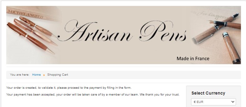

SumUp are returning a payment status to the shop but the shop is not auctioning it.
Have I missed something?
  • Posts: 86177
3 years 1 month ago #353437
I'm sorry but I don't understand what you mean. Where is Sumup returning a payment status ?
To a URL ? Which one ?
What do you mean by "the shop is not auctionning it" ? You mean the shop is ignoring it ? How do you know that ? Do you have access to some log with that information ? Or is that something Sumup's support told you ?
What is the link with your screenshot ? This screenshot just looks like the thank you page of HikaShop, which you've customized to adapt the text. But the customer coming back to that page has nothing to do with the payment notification as far as I know.

The screen shot is what is shown after the customer (me with a gmail address) has entered their card details and pressed 'pay' but that is all that happens (my SumUp account is credited at that point).
I would expect the order status to be changed to 'completed', the cart emptied and the product quantity to be reduced, none of which happens.
SumUp's support isn't as good as yours and I'm still waiting for a reply from them.
I hope this is understandable.

It should be the URL on your screenshot:
www.hikashop.com/media/kunena/attachment...659_2023-07-17-2.jpg

nicolas wrote: Hi,
nicolas wrote: Hi,
Thanks, I hadn't noticed but that URL had more after the ? I have changed it to just artisan-pens.com/index.php and it's made no difference.

You need to use the full URL with everything after the ? too.

I've entered the full URL ( artisan-pens.com/index.php?option=com_content&view=article&id=4 ) in the return address and still not working.
