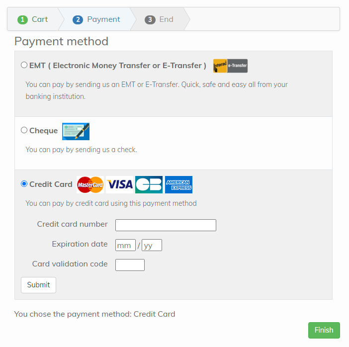

-- url of the page with the problem -- : simcoecurlingclub.ca/online-proshop/checkout
-- Joomla version -- : 3.10.1
-- PHP version -- : 7.4.11
-- Browser(s) name and version -- : Chrome 93.0.4577.63

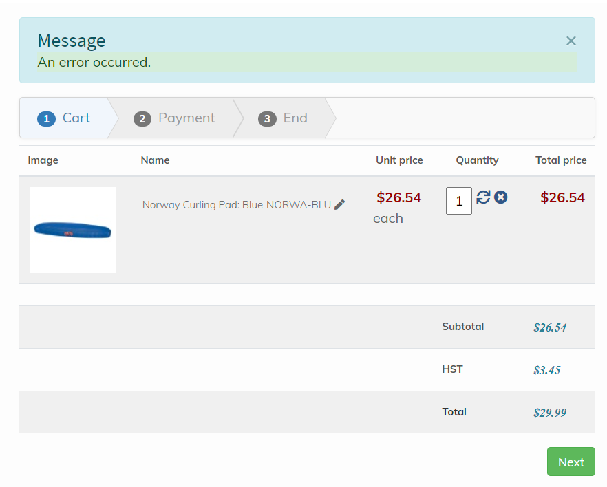

-- Error-message(debug-mod must be tuned on) -- : An error occurred.
Using the HikaShop VirtualMerchant payment plugin. The Merchant ID, User ID and pin were copied and pasted, check for spaces before and after.
Site already has a custom payment using this merchant ID, with user ID ad pin. Also has an event registration that has a virtualmerchant payment plugin with this exact same info set for Live and it has been tested and working.
I have access to Converge to see any transactions, or access the accounts with pin and so far no transaction attempts.
Turned debug on joomla, system debug plugin so can see the debug console as well. Debug turned on in the VirtualMerchant payment plugin settings. Nothing is displayed other than once the credit card info is entered the info is accepted and then after processing the "An error occured" is at the top of the checkout.

I have tried with the "debug" setting of the payment methold. Toggled on or off makes no difference.
As for connections, the same site has VirtualMerchant processing 2 other payment plugins, for membership and one for event registration. They use the same merchant ID, username and pin and have been tested working.
And any debug settings show no communcation information, just the friendly error. Debug console in Joomla shows nothing of interest either.
