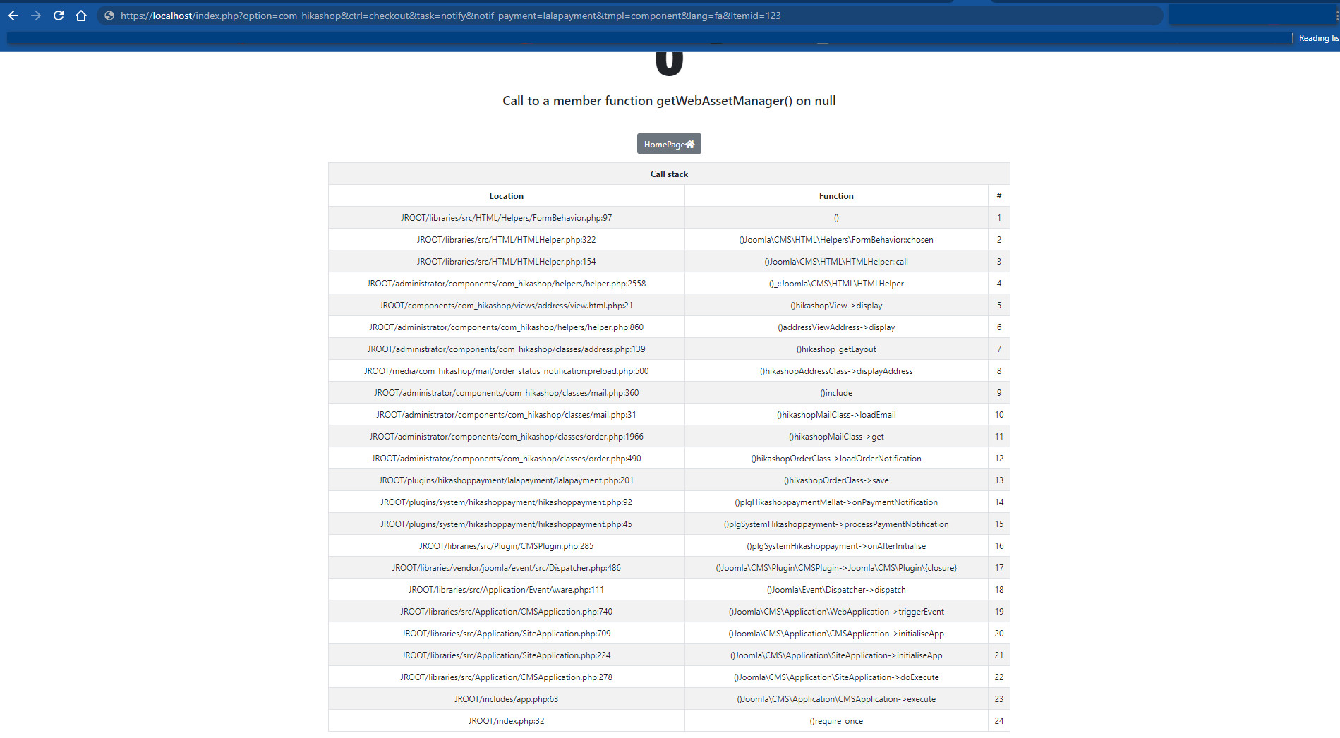

I get the following error when I return from the payment gateway. It does not matter if the payment is successful or unsuccessful. In any case, after returning from the bank, I encounter the following error.
0 Call to a member function getWebAssetManager() on null
I have provided the details of the reporting error below:
Thank you.

4 years 11 months ago #336380
by nicolas
Replied by nicolas on topic getWebAssetManager error in payment process.
This is kind of a bug in Joomla. Joomla is trying to use WebAssetManager before it has been loaded. Of course, I suppose that it's because HikaShop is asking for chosen to be loaded at a place where it can't be loaded. Ideally, Joomla should check that WebAssetManager has been loaded, if not, throw an Execption that the code calling would then be able to catch to handle the situation gracefully.
Now of course, we can also fix the issue by not loading chosen in your case as it's probably not needed there, when trying to send an email. However, as the call stack provided is only a piece of the full callstack and you didn't give the URL of the page where the error happens, I'm not sure of the situation you're in when the error happens so I can't write a condition to avoid loading chosen. Thus, I'll need more information from you.
Could you provide the rest of the call stack debug ?
Could you also provide the URL of the address bar on your browser when you get that error ?
Also, which payment plugin are you using ?

4 years 11 months ago #336381
by farzadfarzad
Replied by farzadfarzad on topic getWebAssetManager error in payment process.
hi
Thank you for your explanation. I attached the full image of the debug.
4 years 11 months ago #336384
by nicolas
Thanks !
Add the line:
$this->chosen = false;
after the line:
public function address_template() {
in the file components/com_hikashop/views/address/view.html.php and that will prevent the issue.
We'll add that patch on our end too.

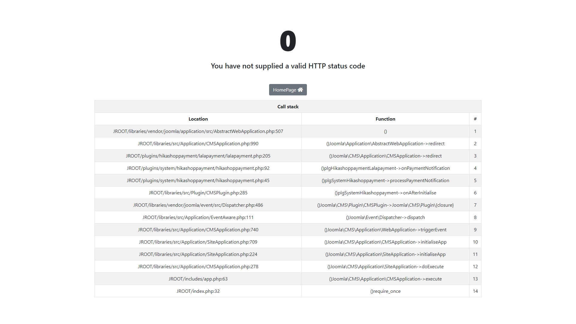

I made the changes you announced, but now I have the following error!
Thank you for your help.
Code:
0
You have not supplied a valid HTTP status code

4 years 11 months ago #336410
by farzadfarzad
hi
There is a problem returning from the payment gateway, which encounters this error. The error is related to the $ app-> redirect section.
thank you.

4 years 11 months ago #336415
by nicolas
The issue comes from the two calls to $app->redirect
On Joomla 4 you can't add the message to display as second parameter of the redirect function call as it now expects a HTTP status code instead.
So instead:
you should have:
and it will work on both Joomla 3 and Joomla 4.
I recommend you report this to the developer of your payment plugin.
