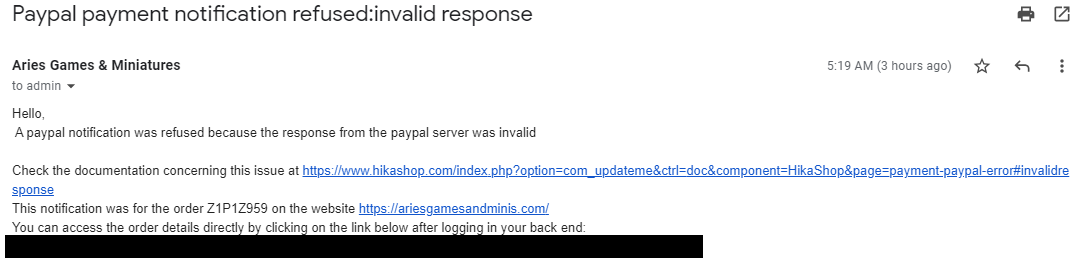

-- url of the page with the problem -- : www.ariesgamesandminis.com
-- HikaShop version -- : 4.4.4
-- Joomla version -- : 3.10.3
Out of no where, PayPal has started providing Invalid responses for Payments that have actually gone through.
I've made no changes to the site in the last 3 days, and this started overnight yesterday.
Can you please investigate as it seems this could be an IP response? It's causing some havoc on my site with people buying items.
Thank you
