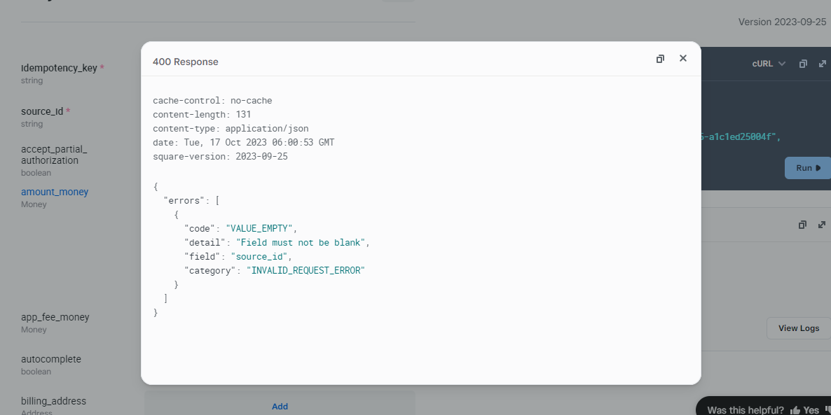

Having the exact same problem.
I sse this in the debug payment log but not sure what field is empty:
[result:Square\Http\ApiResponse:private] =>
[body:Square\Http\ApiResponse:private] => {"errors": [{"code": "VALUE_EMPTY","detail": "Field must not be blank","field": "source_id","category": "INVALID_REQUEST_ERROR"}]}
[errors:Square\Http\ApiResponse:private] => Array
[0] => Square\Models\Error Object
[category:Square\Models\Error:private] => INVALID_REQUEST_ERROR
[code:Square\Models\Error:private] => VALUE_EMPTY
[detail:Square\Models\Error:private] => Field must not be blank
[field:Square\Models\Error:private] => source_id
[cursor:Square\Http\ApiResponse:private] =>

  • Posts: 1
2 years 9 months ago #355924
Yes, I have a same problem like above. How to fix it?
  • Posts: 85952
  • Thank you received: 14142
2 years 9 months ago #355935
You indeed seem to have the same error as @jazzmang and he said that after entering the correct credentials in his Square payment method it worked fine.
So it's probably the same problem. I would recommend you to double check the credentials with the Square merchant support and to check that you don't have extra spaces before / after the credentials in the settings of the payment method as it could invalidate them.
