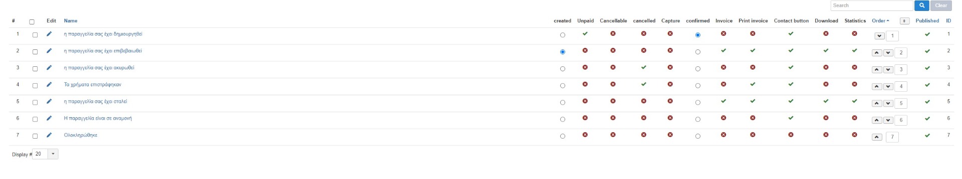

Hello!
It was already checked (see printscreen)
The email came with the link but the order was cancelled (I tested by pressing cancell on the banks page)
But when I was redirected back on the website the order was cancelled

4 years 9 months ago #337906
What you can do is activate the "cancelled" status in the "unpaid" column of the System>Orders statuses menu.
That way, cancelled orders can still be paid.
However, normally, if you set the "clean cart when order is" setting to "confirmed" instead of "created", then the cart will only be cleaned after the customer comes back on the website after a successful payment, and otherwise, he will be back on the checkout and it can proceed to the payment again easily.
