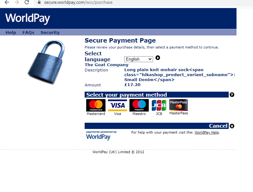

-- Error-message(debug-mod must be tuned on) -- : raw HTML showing in WorldPay
Hi All,
Just upgraded to 4.4.5 from 4.4.4 and going through the test scenario discovered the description is displaying some raw HTML in the WorldPay Description box?
Ian

That's a bug in the WorldPay plugin that has always been there. Thanks for reporting it.
It only happens when you have products with characteristics/variants in the order and it is not linked to the update.
You can fix that by changing the line:
$vars["C_item_name_".$i]=substr($product->order_product_name,0,127);
to:
$vars["C_item_name_".$i]=substr(strip_tags($product->order_product_name),0,127);
in the file plugins/hikashoppayment/bf_rbsbusinessgateway/bf_rbsbusinessgateway.php
We'll add that on our end too.

4 years 8 months ago #338503
Made the mod, but no change?
I've set the plugin to show only the company and price at the moment.
Ian

4 years 8 months ago #338528
Thanks. I found the problem.
There is another line to change.
You need to change:
$vars['desc'] = substr($product->order_product_name, 0, 255);
to:
$vars['desc'] = substr(strip_tags($product->order_product_name), 0, 255);
in that same file and it will work.
The following user(s) said Thank You: ianspeed

4 years 8 months ago #338548
All working now, thanks.
