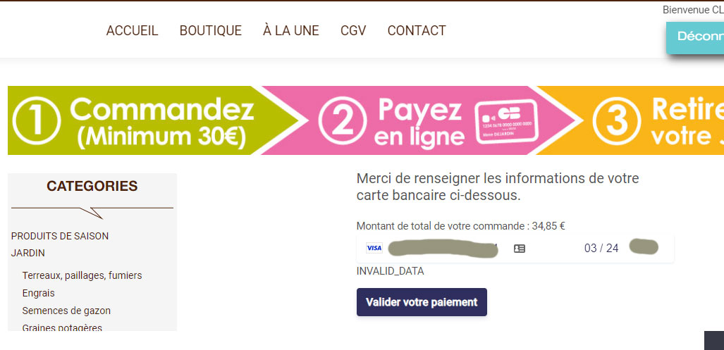

-- url of the page with the problem -- : www.jdea.fr/boutique-jardins-comtois/checkout/confirm
-- HikaShop version -- : 4.
-- Joomla version -- : 3.9.13
-- PHP version -- : 7.3.33
Please consider this ticket as high priority as no payment is possible.
On checkout page the card datas can't be validated : message INVALID_DATA (see image enclosed).
We have installed the last version of plugin "stripeconnect_hikashoppayment" but the pb remains.

4 years 5 months ago #340368
Regarding the log, it looks like the the error is due to an expired "payment intentent", due to the usage one hour after its creation.
I replied to your message in order to retrieve more details regarding the test context.
