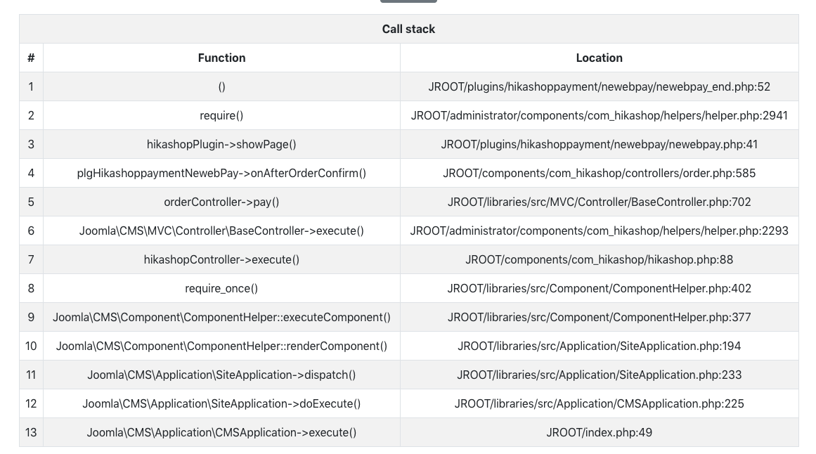

-- Error-message(debug-mod must be tuned on) -- : Object of class stdClass could not be converted to string
I got an error message when I use the pay now function for the order not paid immediately.
The message shows "0 Object of class stdClass could not be converted to string".

  • Posts: 20
4 years 5 months ago #340437
Thank you for your help.
The attachment is the error message that I got.
Best.
  • Posts: 86220
  • Thank you received: 14222
4 years 5 months ago #340439
This confirms that there is an issue in the code of the Newebpay payment plugin.
So the first thing to do is to report the error message along with the callstack screenshot you made to Newebpay support.
That way, they'll be able to add a fix to the plugin and provide you with a new version which will avoid the problem.
The issue happens only in some cases but I think the issue is linked to changes made to PHP with the 7.4 version. So that's probably why it worked fine in the past, with earlier versions of PHP.

  • Posts: 86220
4 years 5 months ago #340460
I don't think it is linked to the same order number.
Your screenshot points at some code in the newebpay plugin file to handle the redirection to the payment gateway.
