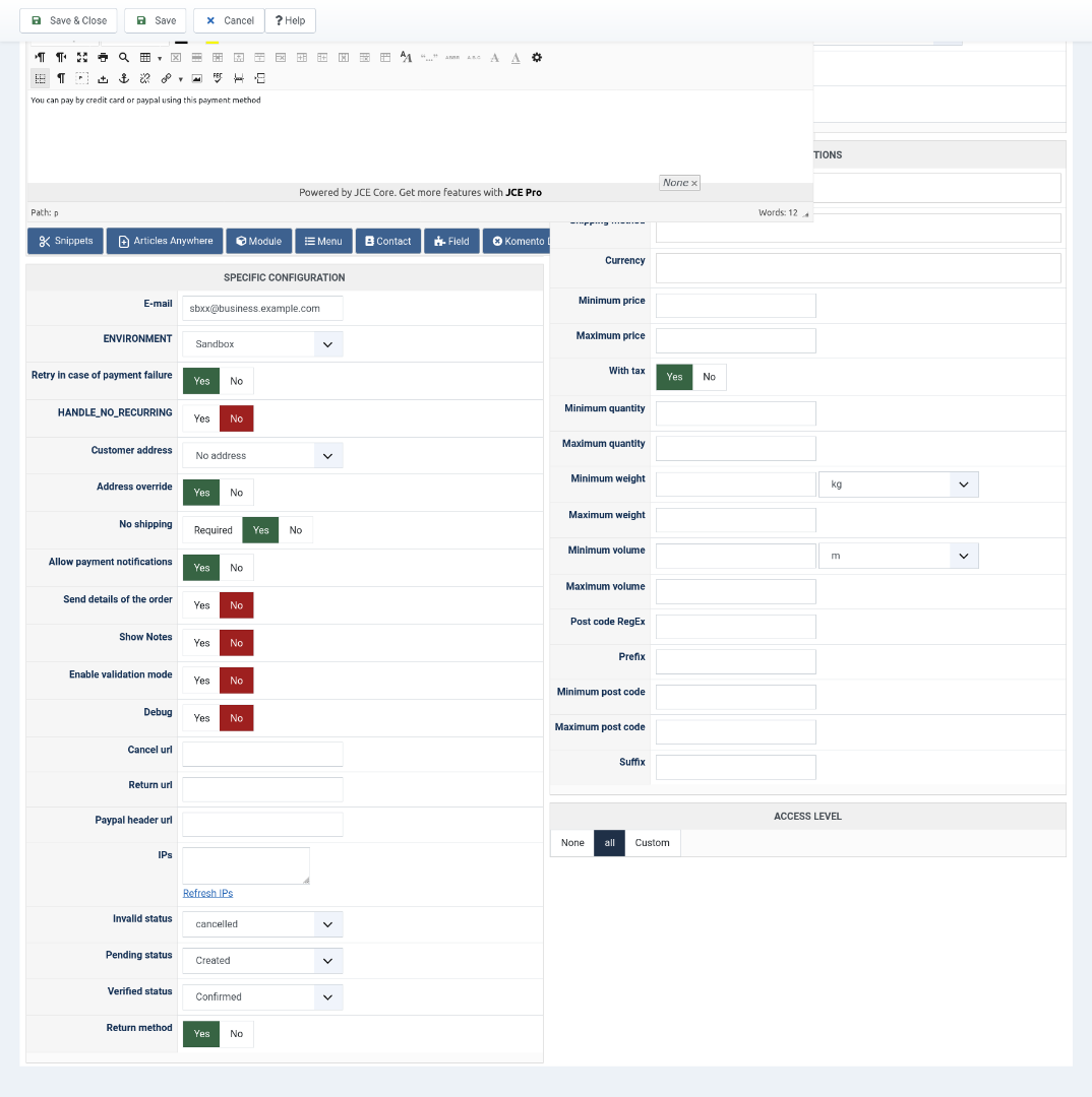

Also, PayPal recurring does not work here: when I confirm the payment (testing mode) - I am directed to the PayPal home page and the possibility of proceeding with the payment is lost.

Regarding PayPal recurring not working, we would need more information. Could you provide a screenshot of the settings of the payment method ? Could you provide a link to the shop and instructions to reproduce the problem ?
  • Posts: 18
3 years 9 months ago #344854
Ok, with the recommended configurations everything works fine. Thank you !
The payment problem remains, I am attaching the screenshot.

I can see that you're using the PayPal sandbox. Did you activate the recurring capabilities of your sandbox account ?
stackoverflow.com/questions/15848191/how...-for-sandbox-account
  • Posts: 18
3 years 9 months ago #345112
yes, I have checked, and it is active.
  • Posts: 85837
  • Thank you received: 14097
3 years 9 months ago #345116
Then I don't know why it does this because the PayPal recurring plugin is redirecting to PayPal.
Please contact PayPal merchant support so that they can check the situation:
www.paypal-support.com/s/?language=en_US
Last edit: 3 years 9 months ago by nicolas.
