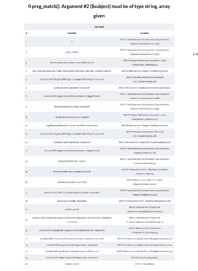

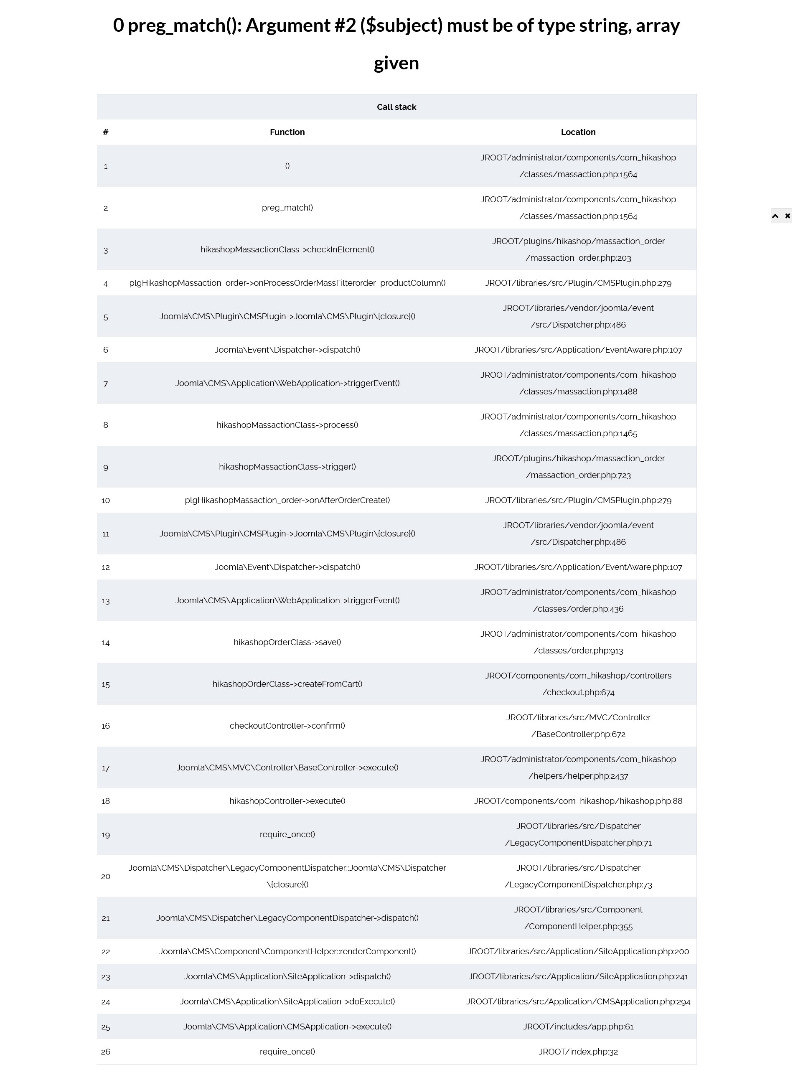

  • Posts: 104
3 years 3 months ago #350831
Hi Nicolas
If I turn on debug and have PHP8.1 on the site as soon as you click checkout, it completely breaks and the page does not render.
If I turn off debug and turn on max error reporting I get the following as soon as I click finish after selecting payfast as payment option.
8192 Return type of Twig\Node\Node::count() should either be compatible with Countable::count(): int, or the #[\ReturnTypeWillChange] attribute should be used to temporarily suppress the notice
If I turn on PHP 8.0 and then turn on debug the checkout page doe render, if I click finish however I get the following
If I turn off debug on PHP 8.0 the transaction seems to process correctly using payfast, so now I am not sure if it is a payment plugin issue or something else.
  • Posts: 85952
  • Thank you received: 14142
3 years 3 months ago #350846
The detailed error message indicates that the error happens with one of your mass actions.
It's trying to apply a "contains" filter on a column which doesn't have a valid format.
On older PHP versions, it works fine because it's less strict and it just fails the check without outputting an error, but on recent versions of PHP, it crashes as it is a lot more strict.
So what you can do is to use PHP 8.1 and disable your mass actions one by one to identify which one is the problem. Once that's done, please provide the screenshot of the settings of that mass action so that we can investigate.
