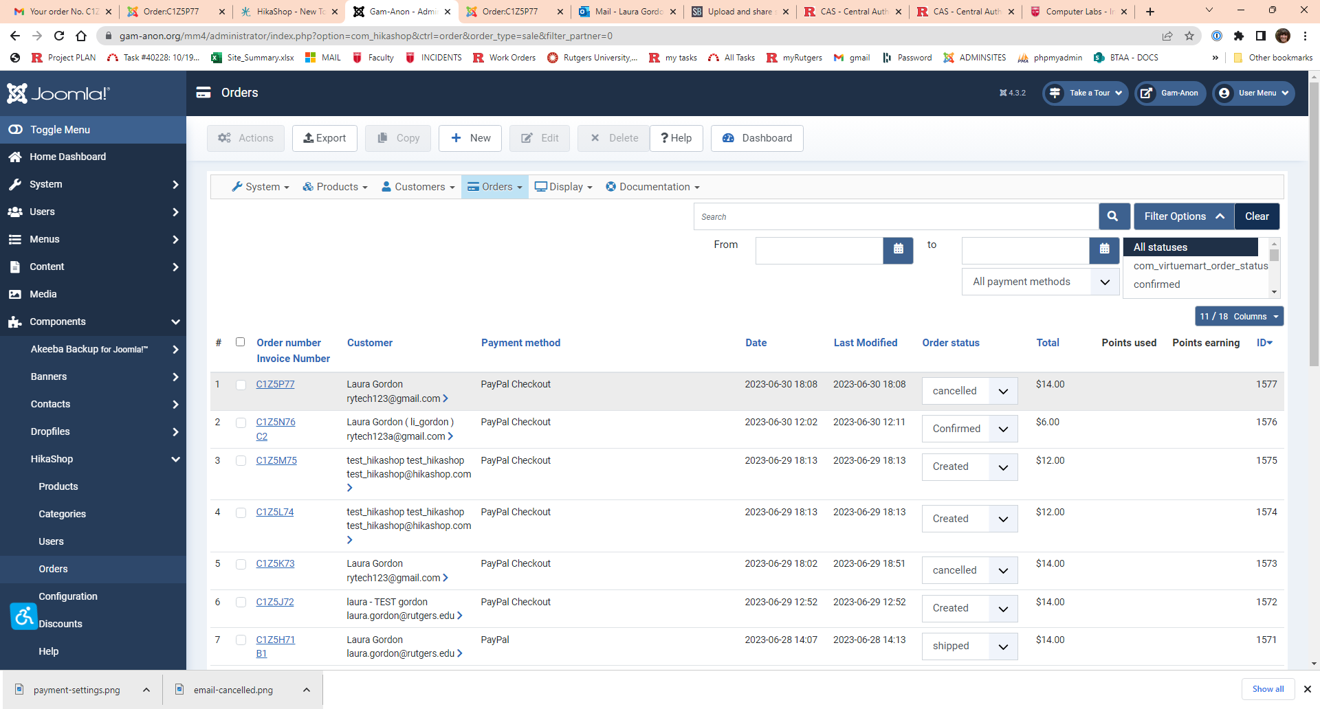

After payment is CONFIRMED, the order is being set to CANCELLED
Order:

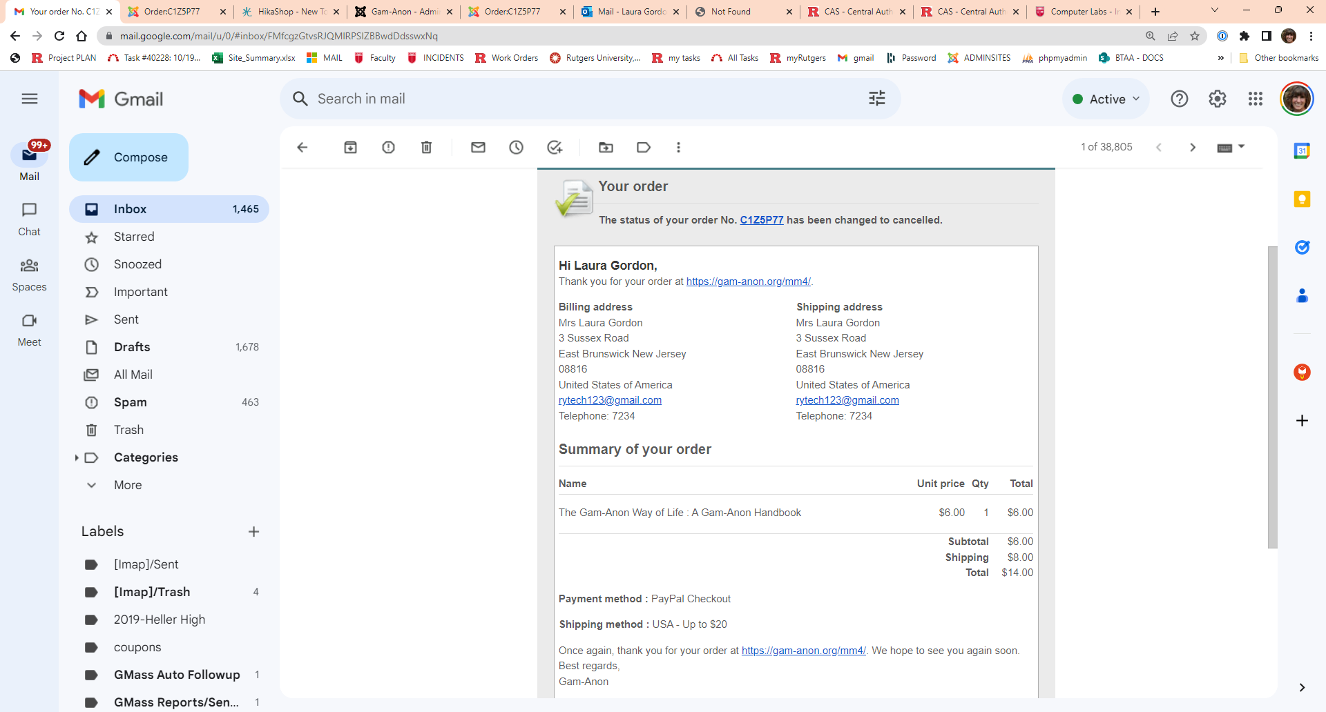

I have attached images of the email that I received that it was CANCELLED

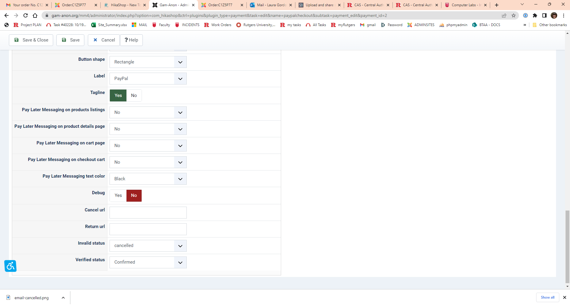

The payment settings in the system, Cancelled is only if it is invalid

Can you try again after activating the "debug" setting of the payment method settings page ? Then, please look at the "payment log file" option of the HikaShop configuration. It should have information on what's going on.

Here is my order link:
gam-anon.org/mm4/literature-summary/shop...order_token-2YiQQO38
I used the CREDIT CARD option for payment.

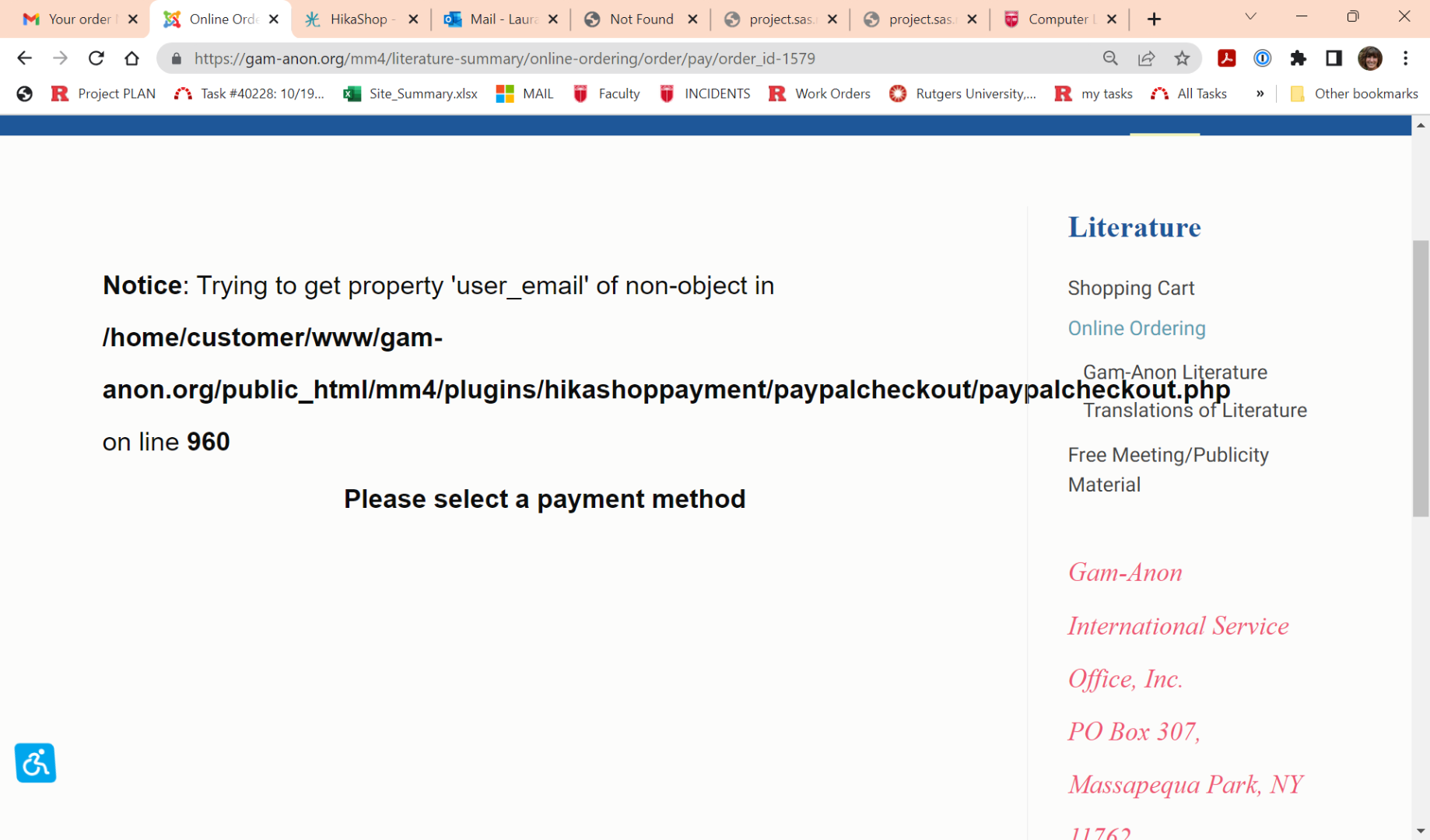

I received the following error on the page after I clicked paypal
Notice: Trying to get property 'user_email' of non-object in /home/customer/www/gam-anon.org/public_html/mm4/plugins/hikashoppayment/paypalcheckout/paypalcheckout.php on line 960
Please select a payment method
This is the SAME ERROR that I had a few days ago, that I mentioned... is there something going on with the user_email address field???
