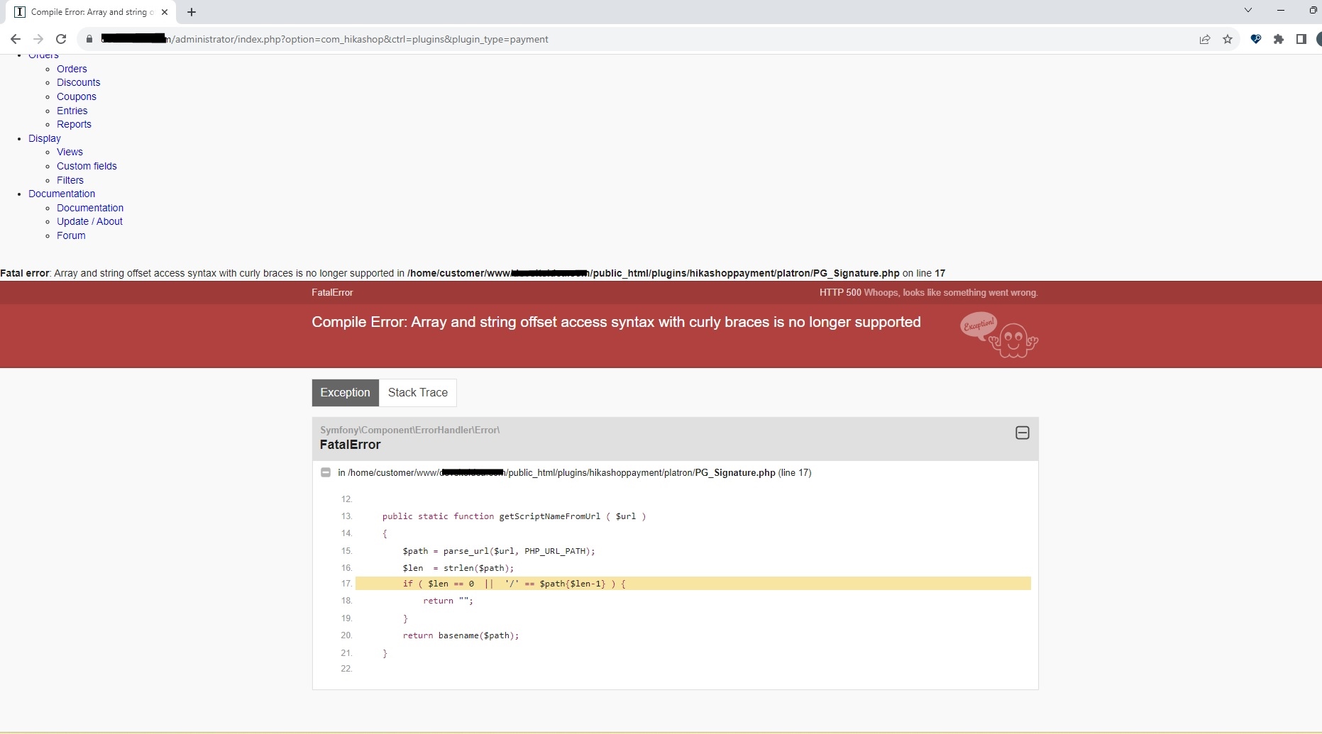

Fatal error when trying to add a new payment method
  • Posts: 54
2 years 10 months ago #354912
-- HikaShop version -- : 4.7.5
-- Joomla version -- : 4.3.4
-- PHP version -- : 8.0
-- Browser(s) name and version -- : Mozilla & Chrome
-- Error-message(debug-mod must be tuned on) -- : Fatal error: Compile Error: Array and string offset access syntax with curly braces is no longer supported
I am trying to add a new payment method. When I click on the New button under System -> Payment methods I get a fatal error. With maximum reporting on the error says: Compile Error: Array and string offset access syntax with curly braces is no longer supported and this error is happening in plugins/hikashoppayment/platron/PG_Signature.php (line 17). I have attached a screen shot.
The following user(s) said Thank You: Remko
  • Posts: 85952
  • Thank you received: 14142
2 years 10 months ago #354917
This error means you have an old version of the Platron plugin, which is available here:
github.com/HikaShop/hikashoppayment-platron
Your version is not compatible with PHP 8.
If you're using it, update it.
If you're not, uninstall it in the Joomla extensions manager
Either way, it will fix the problem.
