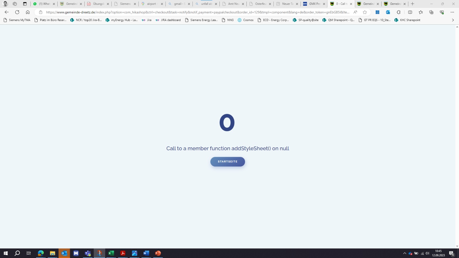

-- Error-message(debug-mod must be tuned on) -- : call to a member funktion addstylesheet() on null

Regarding the error "call to a member funktion addstylesheet() on null", we'll need the full error message to be able to tell you what to do. Please activate the "debug" setting of the joomla configuration page and try again. You'll see the full error message. Please provide a new screenshot of what you see on the page.

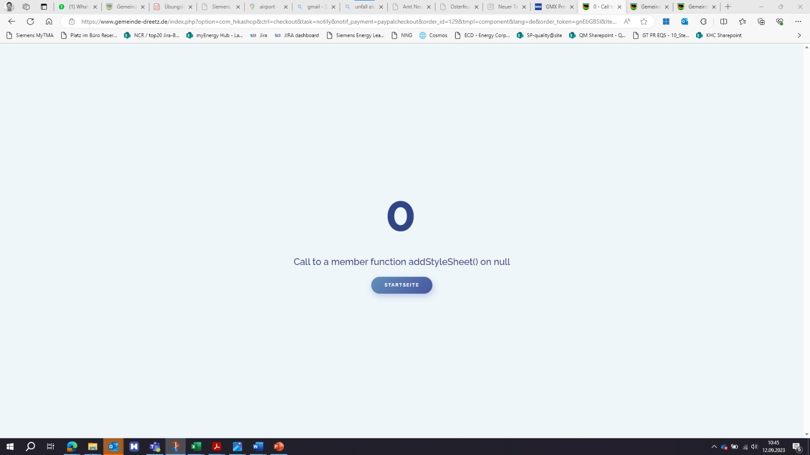

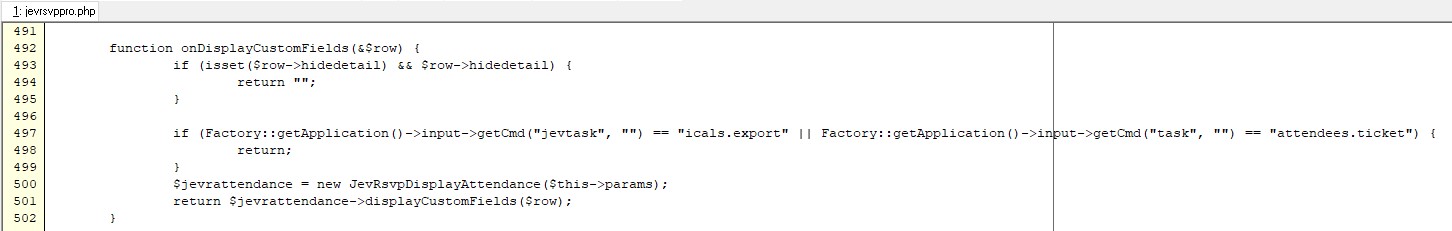

The error "call to a member function addstylesheet() on null" still exists. Attached are the screenshots as requested. Maybe it's because of jevents?
Many thanks
Martin

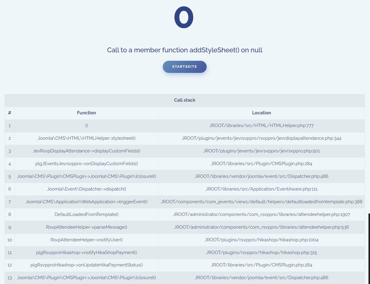

2 years 10 months ago #355096
The error is in JEvent RSVP Pro. You need to contact their support and report the issue with the screenshots you provided here. They should be able to tell you what to do.
