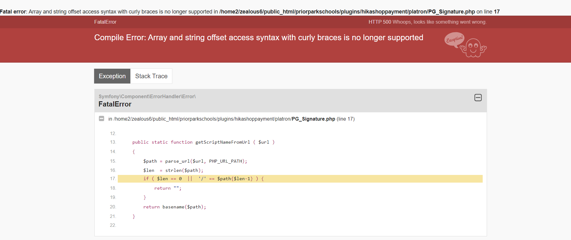

Error 2:
When I follow the steps you said I see the attached error
thank you

2. This error indicates that you're using an old version of the platron payment plugin.
Update the plugin ( github.com/HikaShop/hikashoppayment-platron ) or uninstall it from your website and you won't get the error.

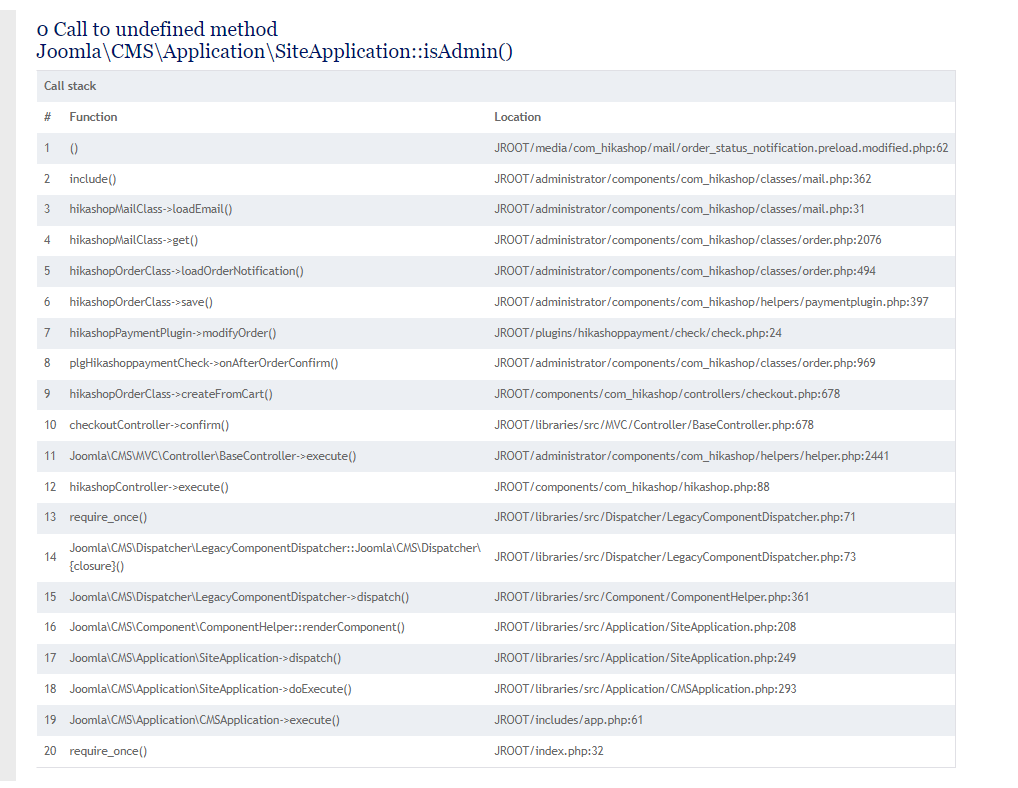

  • Posts: 34
2 years 10 months ago #355223
thank you debug now on
Error 1 - see screen grab

2 years 10 months ago #355227
About your error 1, their are good chance that your issue is because you use an mail override of your "order_status_notification".
To check this idea, can you save on your side your overrided email code, and process a test ?
If your error isn't anymore, then you have to redo your email override (from the last email version).
Hope this will help you.

  • Posts: 34
2 years 10 months ago #355244
brilliant that worked - thank you
