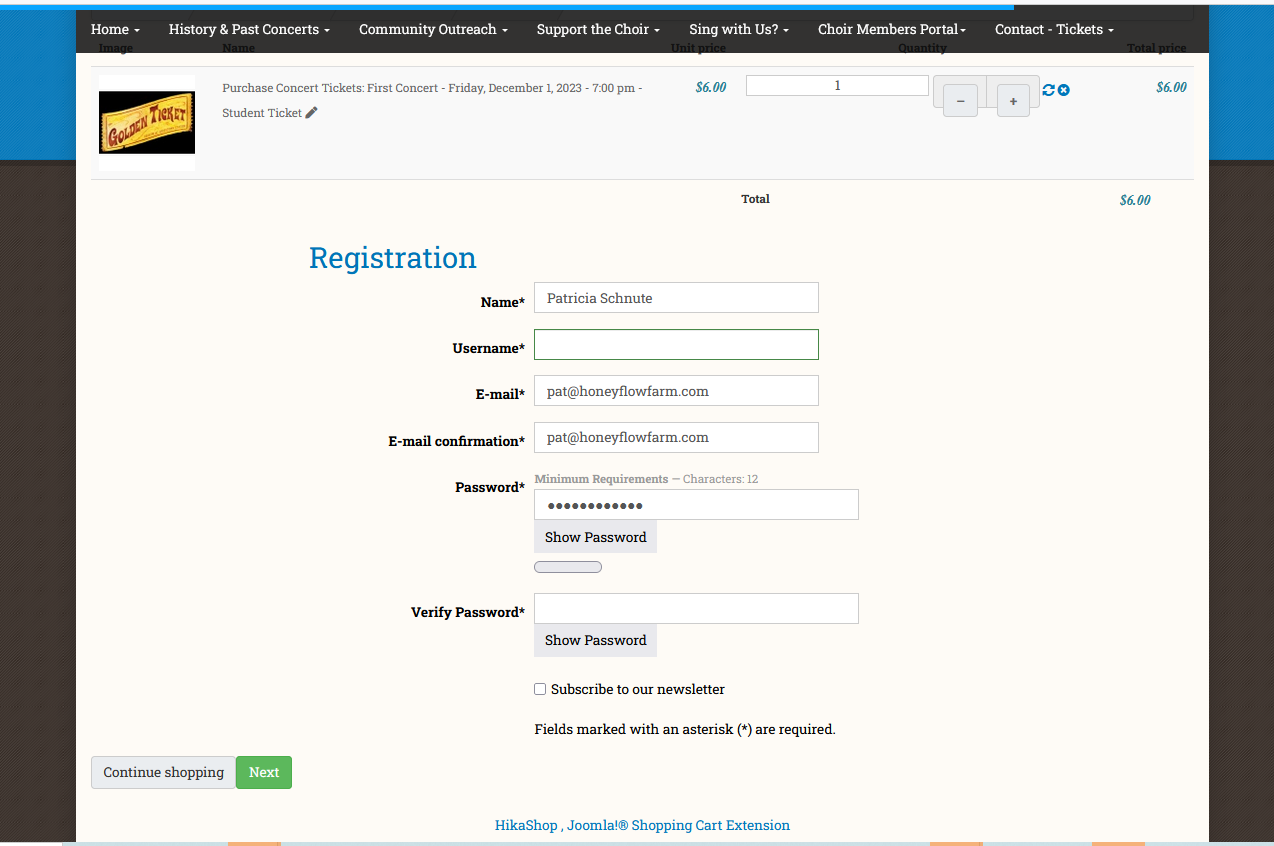

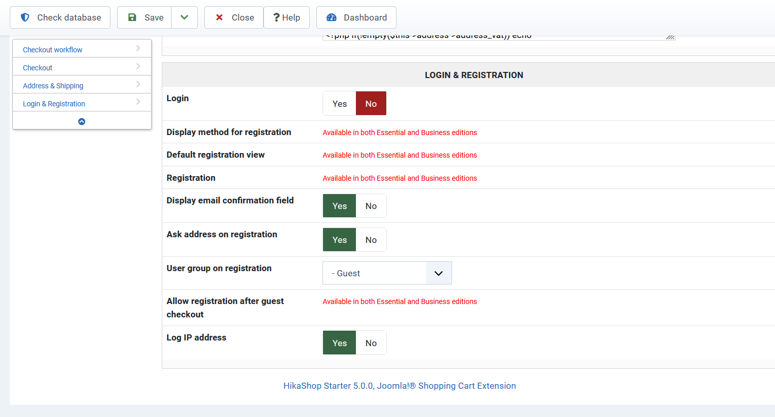

Hello - Renaming the platron folder took care of that issue and I added new stripe and paypal plugins - but now I lost my "guest login" . attached is the setup
Is it set up correct? Here is link to checkout: "brands-listing"
lapeercountyconcertchoir.com/index.php/h...isting/checkout.html
(purchase tickets link for testing = lapeercountyconcertchoir.com/index.php/s...tickets-on-line.html

From your screenshot it seems that you use a starter (free) version, and so as you can see here , it's quite normal that you can no longer use guest checkout with the Starter.
You have to use at least the Essential version to be able to have the guest checkout.
Last edit: 2 years 10 months ago by Philip.
