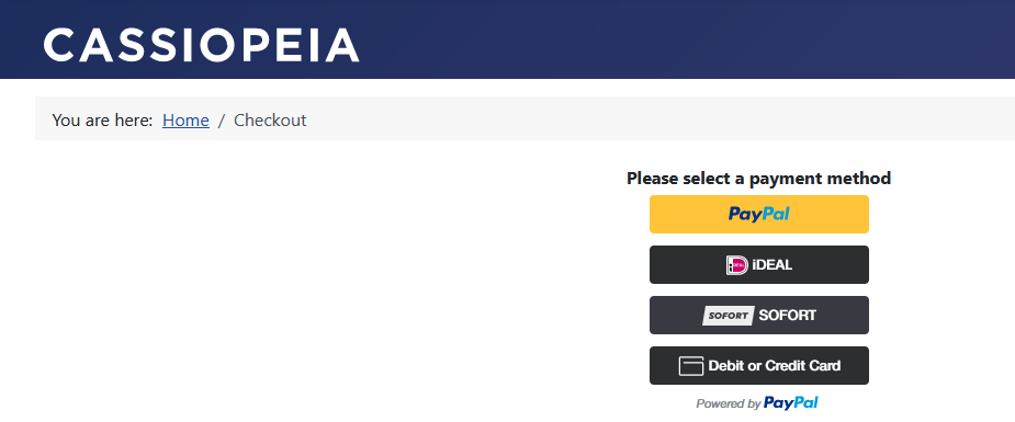

When I place an order, I can go through all the steps of the checkout process, and I end up at the screen where I can select my payment method through Paypal. (See attached screenshot.) When I do however, a Paypal logo flashes across the screen briefly, but nothing else happens. I never get redirected to the Paypal page as I did previously.

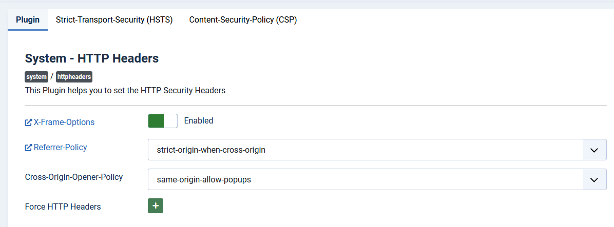

I already found some posts on this forum describing similar issues ( www.hikashop.com/forum/payment-methods/9...checkout.html#356942 ) that were fixed by adjusting a setting in the "Cross-Origin-Opener-Policy" option to "same-origin-allow-popups". I did this and cleared my cache, but the issue is still there.
