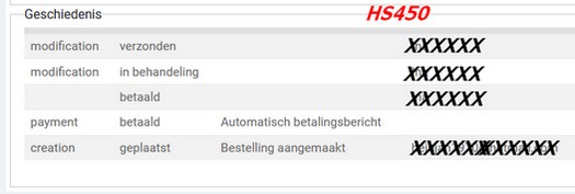

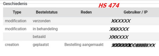

In the attachment are pictures of an order history in 4.5.0 and in 4.7.4. In 4.5.0 the automatic payment notification is present. In 4.7.4 it's absent.

Because normally, when a payment plugin automatically confirms an order, it fills the "reason" of the history with "automatic payment notification received".
Based on your screenshots, it seems this was the case before and not the case anymore.
