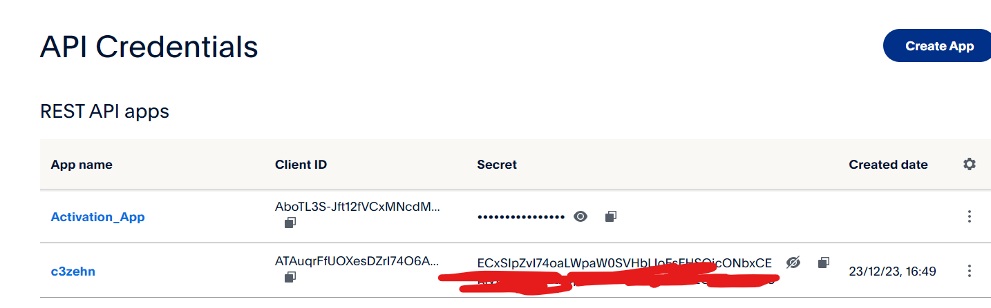

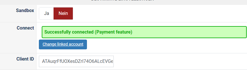

  • Posts: 39
2 years 8 months ago #357827
this is what is comming when i want to Pay with it
The payment request was refused by PayPal. Please click here to return to the checkout.
but in the Plugin:
thanks
Andy

2 years 8 months ago #357831
Can you provide these elements :
- Precise description your issue (via annotated screenshot, error message)
- A step by step process to reproduce your issue
- An Url link to start the process
Note: Use our Contact us form to provide these elements , and don't forget to add an url link to this topic
=> We need to know exactly what is happening and when.

  • Posts: 39
2 years 8 months ago #357955
hi
here the Screenshot, at the formular it is not Possible, but i send the account by formular.
2 years 8 months ago #357960
After process some tests directly on your website, it seems that you have the blank popup issue.
This issue and his solution is detailed here in our forum.
Hope this will help you to solve your current issue.
