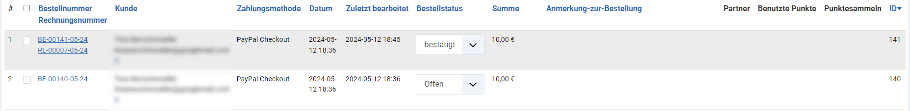

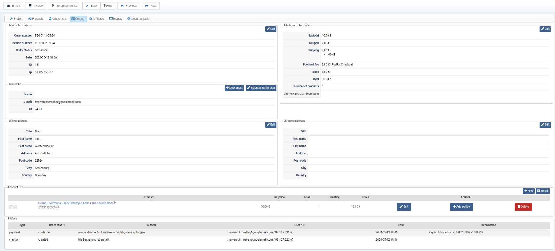

I currently use the PayPal Checkout plugin. Unfortunately, two orders are generated when using the plugin. One remains in the status "open", the other is then correctly set to the order status "confirmed" together with the invoice when the PayPal payment is completed. Unfortunately, this confuses customers as two orders appear to be recorded. I have to explain this regularly and then correct the first (open) order manually. Is there a configuration for this that I have overlooked, or any fix?

  • Posts: 3
2 years 4 months ago #361014
I have deactivated the mail notification for the time being, but I have unclean bookings for the accounting department. I can reproduce the problem 100% with every PayPal payment in the store. As a user, I do not interrupt the payment, but go through the steps in a straight line:
- user clicks on the "finish" button at the end of the checkout
- HikaShop creates the order for the cart (created)
- selected payment plugin display the payment form
- paypal-form opens
- user pays for the order (finished the payment in paypal)
- HikaShop creates a second order for the cart (funded)
- the cart is cleared
In my case, separate OrderIDs are created in each case and the first payment created is not cleanly updated and completed after the payment. It does not seem to find the initial order (created) and simply creates it and then updates the status correctly.
How can I narrow down the problem? Could it be related to other PayPal plugins?

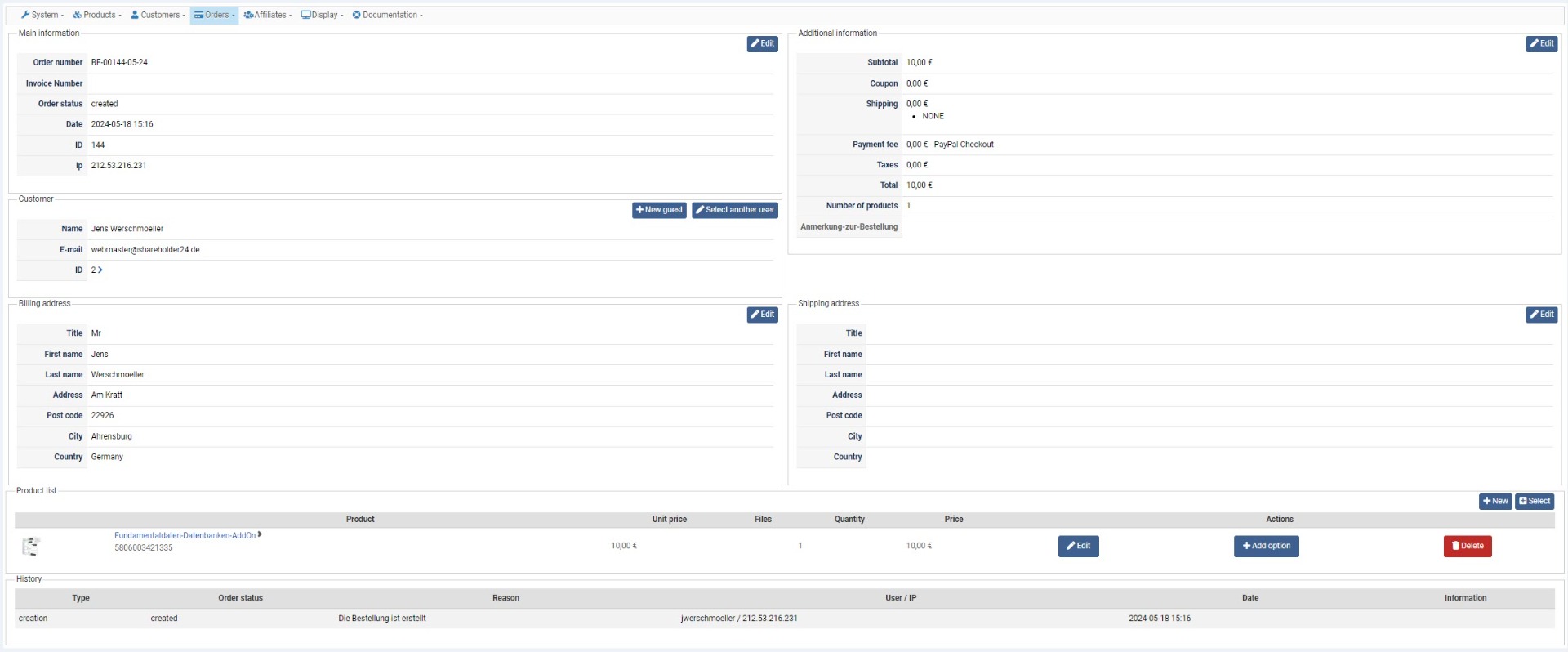

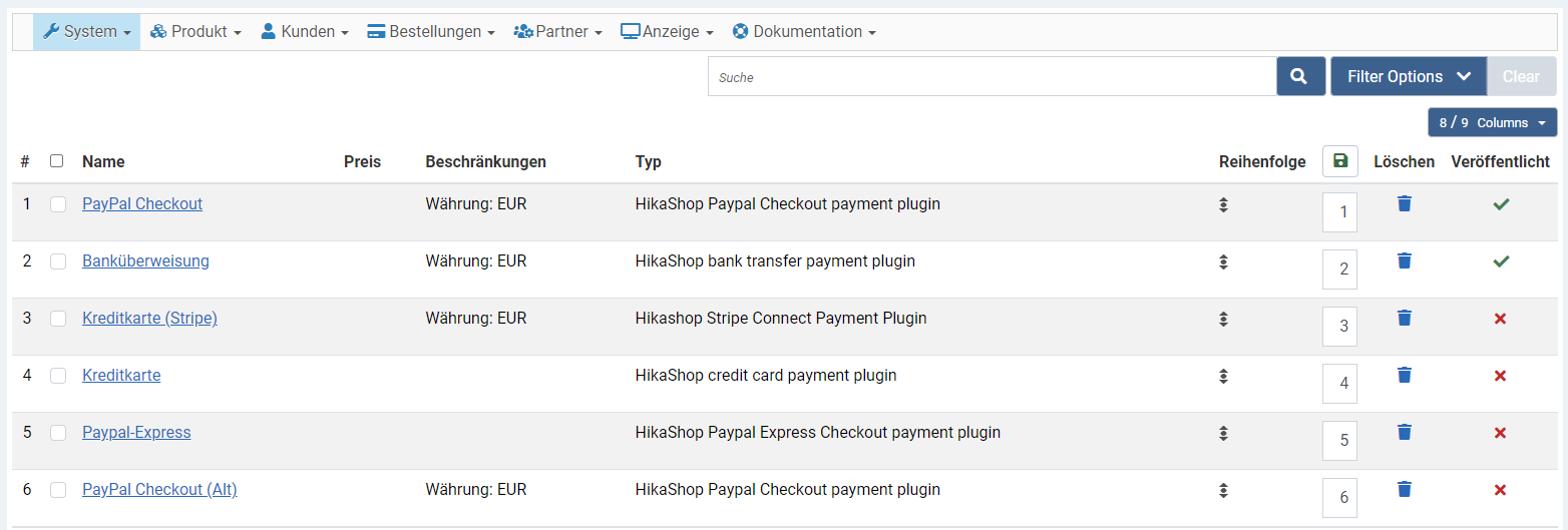

2 years 4 months ago #361017
Could you provide screenshots of the history area of both such orders (while logged in in english) ?
Supposing that what you describe is exactly what happens, then that would mean that another plugin is removing the "order_id" to the $order object in the onBeforeOrderUpdate event fired by HikaShop when the paypal checkout plugin requests HikaShop to update the status of the order in order to set it to "confirmed".
First, I would think this could happen with a massaction. For example, if you had one set with a trigger "before an order is updated", with an action "update the values" on the "order_id" column with a value being 0, then it would lead to this exact behavior.
So please check your mass actions.
If it's not this, then I would suspect a custom plugin or a third party plugin implementing the "onBeforeOrderUpdate event of HikaShop's Order API. Do you have any ?

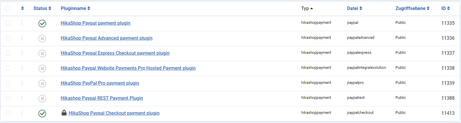

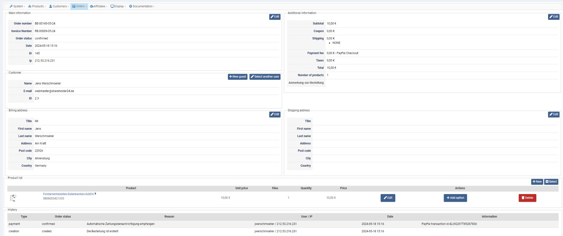

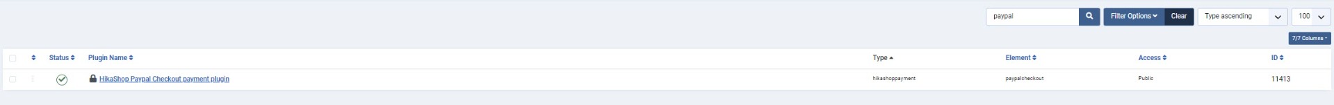

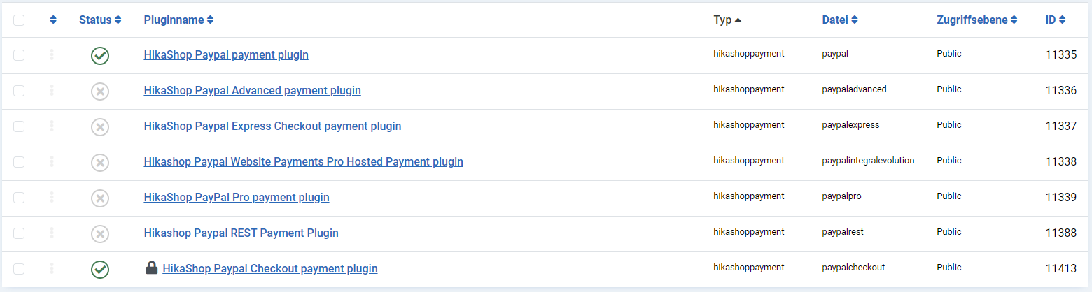

  • Posts: 3

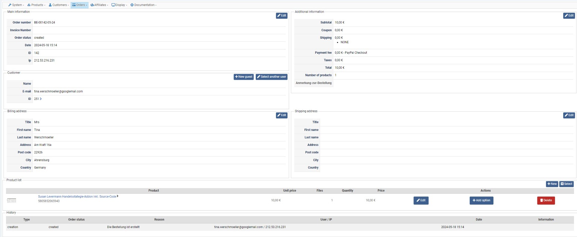

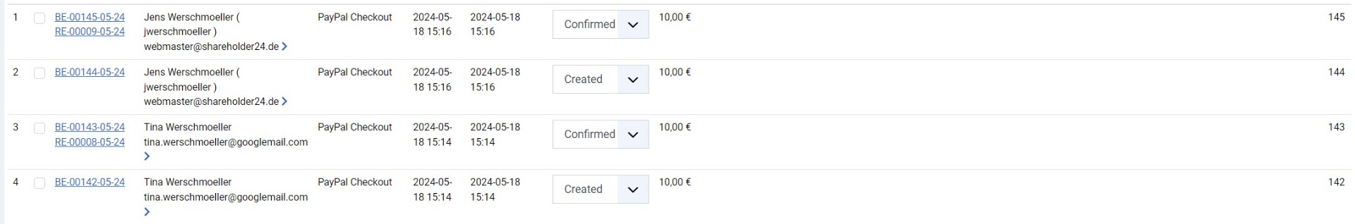

2 years 3 months ago #361104
Hey,
I have executed 2x orders again and as you can see, a duplicate order is created in each case. I have shown screenshots of the order details and exported the Hika order table entries as a ZIP. I have not found any third-party tools or external solutions. I have deleted all deactivated PayPal plugins in the system administration. Since the orders also end up directly in the Hikashop, it would have to be a 3rd party tool for the Hikashop, which I don't have.
Hier aber nochmals die Liste:

2 years 3 months ago #361105
Thank you for the details.
I don't see anything strange with your plugins list or your screenshots.
There is one thing I find strange. In your SQL file you can see the "order_created" and "order_modified" values of the orders.
So if we take the orders with the order_id 144 and 145, you can see that :
- The order 144 is created at 1716038196. As it is not modified after its creation, the order_modified has the same value.
- The order 145 is created at 1716038198 so this means 2 seconds later.
- The order 145 is then modified at 1716038214 (for the confirmation of the order after the payment), so 16 seconds after its creation.
This is strange with the process you provided:
- paypal-form opens
This would mean that between the click of the "finish" button at the end of the checkout, the display of the paypal buttons, the click on one of them, you providing the necessary information to paypal for the payment, only 2 seconds would happen, which is impossible.
And then, after that, the second order would be created and confirmed 16 seconds later without any reason for this delay.
What I proposed as a possible scenario in my first reply is much more likely based on the timestamps of these orders.
Could you please double check your scenario ? I'm thinking you might have been confused somehow.

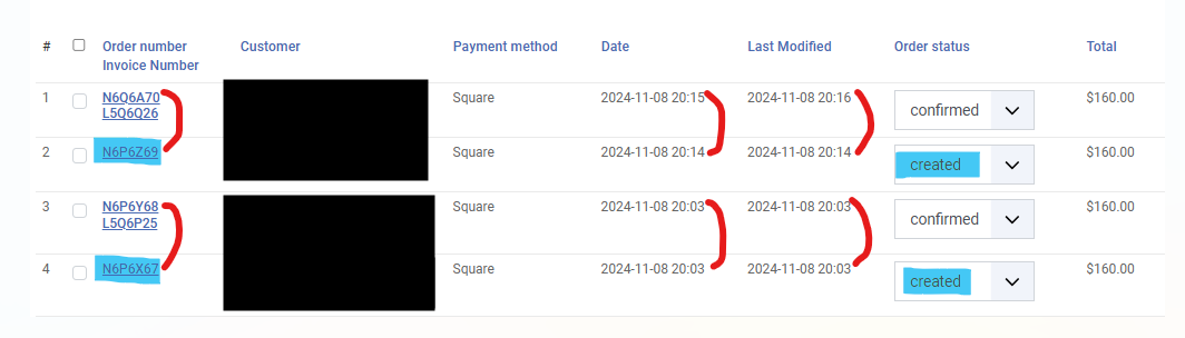

  • Posts: 65
1 year 10 months ago #364352
hi,
Was any resolution found for this topic? My site experiences a similar issue. A user creates an order and then processes it seconds later. End result is hikashop lists a created order with a unique order # and then a second order marked confirmed that has a different order number. On our site the ones marked confirmed are the paid for ones. The ones marks created have not been paid for.
Mostly it's just an annoyance to delete all of the created orders later just to clean things up.
On rare occasion (not always) a person will apply a discount code into the created order that will then be lost in the second order that is processed for payment seconds later. The amount will reflect correctly in the total on the created order. But our discount codes are created set to allow a user to only use it once. So it falls off the second order hikashop processes. But again, that is the rare case.
Is there some setting somewhere I can change to stop the creation of the second order during processing?
Screen shot attached. 1 & 2 are a person's order and 3 & 4 are another person's.
Please advise if you found resolution to the persons item above. I don't see any solution in the thread.
Thank you!

  • Posts: 211
  • Thank you received: 14
1 year 9 months ago #364951
We may be experiencing a similar issue on one of our sites, but maybe not exactly the same? A customer checked out using the PayPal Pro payment plugin, however, in our case 3 orders were created at the exact same time - 2024-11-14 13:47
Before reviewing the forum, I thought the issue might have been that the customer had a slow or delayed internet connection and they clicked the submit button several times.
Would disabling the submit button after the first click prevent duplicate orders?
3by400, Inc.
3by400.com
Websites that Work, Marketing that Matters
  • Posts: 86178
  • Thank you received: 14214
1 year 9 months ago #364956
Your issue is not the same.
HikaShop already disables the "finish" button once the user clicks it, so he should not be able to click on the button several times inadvertently.
Also, with the PayPal Pro plugin, the credit card information is asked to the customer during the checkout, and when he clicks in the "finish" button, the order is created with the status confirmed, and the cart is emptied immediately. So there should be no way to create duplicated orders with it.
So, in short, I don't see how it's possible, unless you're using a really old version of HikaShop, where the finish button was not disabled, or you have a view override of a really old checkout view file which doesn't have the new code to disable the finish button upon click.
