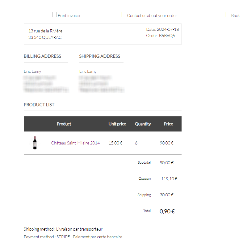

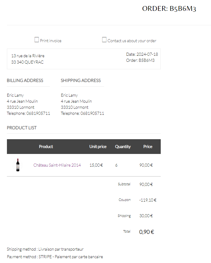

2 years 3 months ago #362160 by erix
Replied by erix on topic Stripe payment doesn't work
nicolas wrote: Hi,
Old versions of the Stripe plugin do not support the update system of Joomla. So it won't tell you if you're up to date or not.
You can see the changelog for the plugin here:
www.hikashop.com/marketplace/product/133...nect-by-obsidev.html
Hello Nicolas,
I have updated the pugin and I have a confirmation on the font that the command is confirm and payed see above
and the order seems to be fine
But when I click on print my invoice, the document is empty..
The order is confirm
Do you have this kind of feedback since the update ?
Adishatz, erix

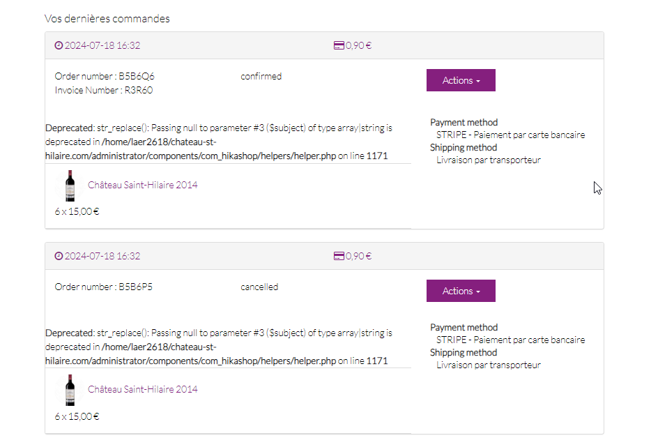

2 years 3 months ago #362265 by erix
Indeed it seems to be a PHP problem. Here is the screenshot on user dashbord
Actually PHP Version is 8.1.29
Adishatz, erix
www.agerix.fr
More
2 years 3 months ago #362270 by nicolas
Replied by nicolas on topic Stripe payment doesn't work
While it is interesting to get this report on the deprecated message, the problem with the invoice doesn't come from this. You need to look at the invoice with the debug activated. Do you see any error message there ?
I've added a patch for this deprecated message. If you download the HikaShop install package on our website and install it on yours you'll get the patch. That will remove the deprecated message of your screenshot. But it won't change anything for the invoice.

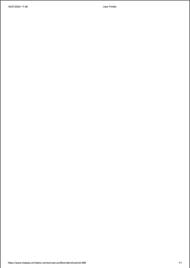

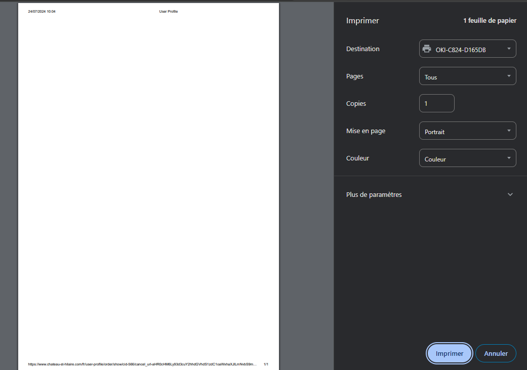

2 years 3 months ago #362275 by erix
Thank you for the patch for deprecated, I don't have anymore the message with debug max.
If I don't publish any screenshot about the printing feature, it is because even with the debug max or error reporting, I still have an empty page for printing
I have the details on order page but I can't print it
Adishatz, erix
www.agerix.fr
More
2 years 3 months ago #362279 by nicolas
I can only think there is some kind of error in a customization of the invoice, or another plugin which needs to be updated (like if you're using an old version of the PDF invoice plugin, or an old version of HikaSerial, or a custom plugin, or something like this).
Could you provide a user access with the URL of an order with the issue so that we could check the situation ? Maybe we could figure out something from directly looking at it.
More
2 years 3 months ago #362291 by erix
I send you the credentials with the contact form. Thank for taking time for this.
Adishatz, erix
www.agerix.fr
More
2 years 3 months ago #362295 by nicolas
Thanks.
If I open the popup URL in a new tab, I can look at its HTML with my browser's inspector. There, I can see all the HTML code of the invoice. So that means that the issue is a CSS issue. So I then looked at the elements encompassing the invoice HTML code and checked their CSS for anything which could hide the area. By going up and up, I finally reached the body tag of the page:
i.imgur.com/K4OM9Kr.png
I can see there is a "modal" class added by the template in the "body" tag of the page. And that class has a "display:none;" in the bootstrap CSS file loaded on the page.
I think that the problem comes from the template adding this "modal" class to the modals content. This was not a problem in older versions of bootstrap, but after updating to a more recent version of boostrap, the modal class' CSS in boostrap must have changed to include that display:none; leading to your issue.
The solution is probably to edit the component.php file of the template and remove the "modal" class from the body tag.
