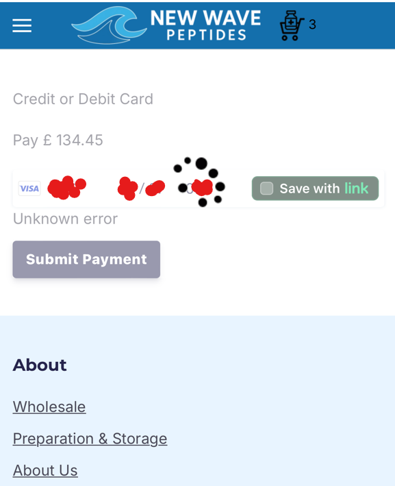

Hi, I have had a few customers now say that when they go to pay, then they just get the spinning icon with the Stripe Payment solution. I have the latest version. You can see the attached image of what they get. This is not all the time, just some times.
Have you had other users mention this and is there any way to resolve this as some of my orders or £100's of pounds that I have lost.

The "Unknown error" is displayed when the server response is not a valid JSON.
In the browser console, the content of the received response is logged ; but it's only client side.
Please check that your website do not display PHP warning directly in web pages ; any content added by a third party plugin could make the JSON invalid.
You can also check in your HikaShop paymenbt log if you have any entry which will indicates an issue during the order confirmation.
If you have the possibility to reproduce the issue ; you'll see the data by opening the browser console (shortcut: ctrl + shift + i )

Sorry for the delay so I looked at the payment log file under media/com_hikashop/upload/safe/logs/report_748435119.log
It has no logs after Feb 2022, is there another setting that should be on to log?
10 months 2 weeks ago #368879
If you don't have any entry in the log, it seems there is no error to log for the plugin.
If you can reproduce the issue, please open the browser console ; the JavaScript will add the received content from the server if if can't process it correctly.
Sometimes it can be related to a system plugin which will add some content and makes the JSON invalid to decode.
If you don't have any error in your log, it'll be the only way to understand what is going on.

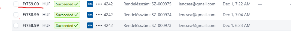

With the Stripe payment method, a tenth of the value of the goods appears on the real invoice on the Stripe interface, and the customer is charged an incorrect value.

Stripe treats HUF as a special currency.
Basically there are no decimals in HUF anymore, so *100 is needed in the code.
I commented out these lines in stripconnect.php and it worked:
/*if((int)$currency->currency_locale['int_frac_digits'] == 0)
$amount = round($total, 0);*/
Last edit: 8 months 3 weeks ago by Jerome. Reason: [code] tag
