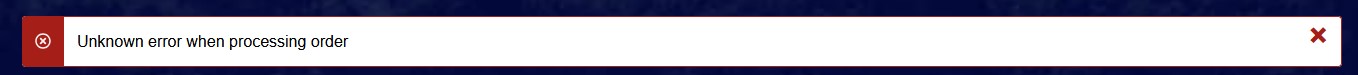

-- Error-message(debug-mod must be tuned on) -- : Error in front-end after the login-modal for PayPal:
Unknown error when processing order
Even with debug mode on and error-reporting on maxumum there is no more information, but the payment is not completed.
Since two weeks I get an error in front-end after the login-modal for PayPal.

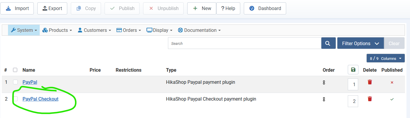

I am using the PayPal checkout plugin
The website worked for many years without problems.
Updating tot Hikashop 6.5.0. did not make a difference.
