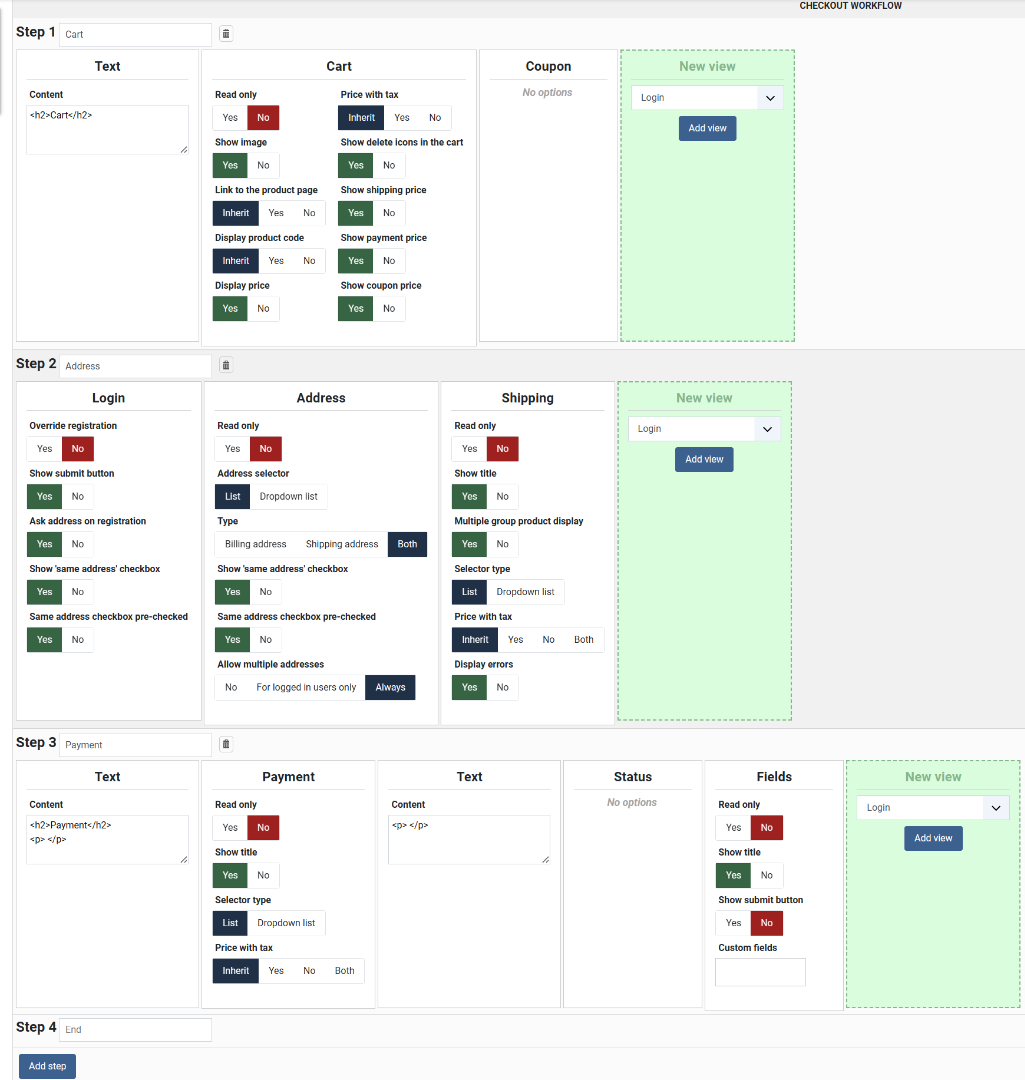

I am attaching a screenshot of our checkout configuration in case it is helpful.

One thing to remember, when we installed HikaShop version 6.6.0. In all of our tests, our order process stalled at Step 1 and would not advance to Step 2 in the checkout process when Next was clicked. We could not complete an order.
