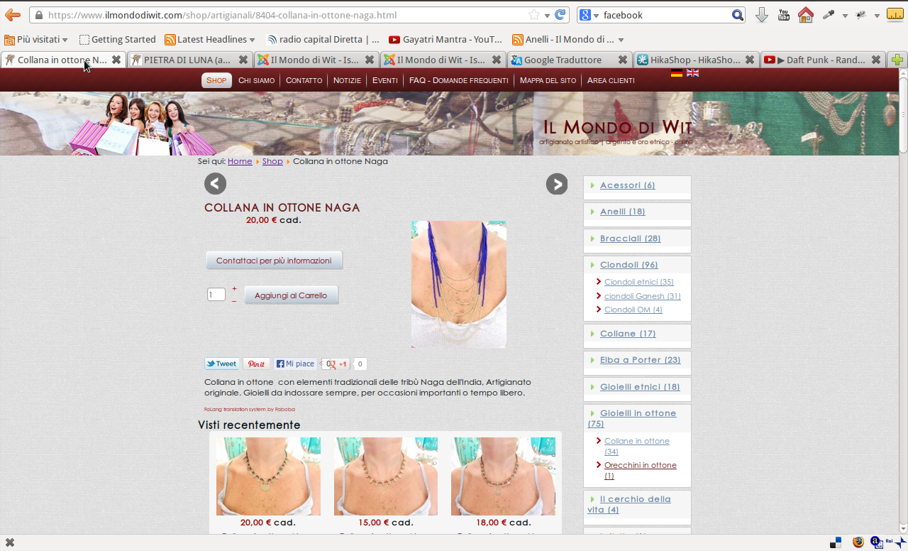

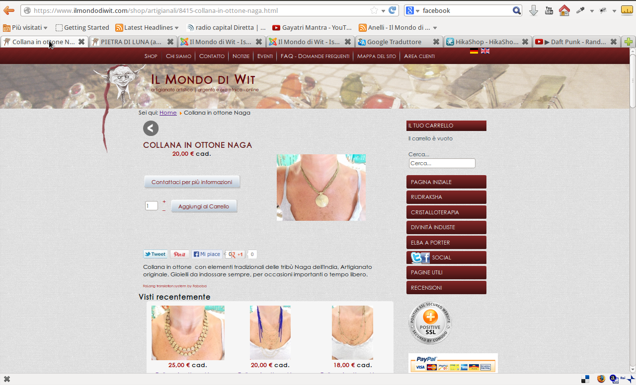

Hallo.
I'm using two templates for my website. one for the hikashop driven menus and one for the rest of the site.
Some products are shown with the right template like here :
www.ilmondodiwit.com/shop/artigianali/81...a-sfera-zircone.html
And some with the wrong template like here:
www.ilmondodiwit.com/shop/artigianali/82...-naga-in-ottone.html
Can you help me in any way to debug this problem?
Thanks.

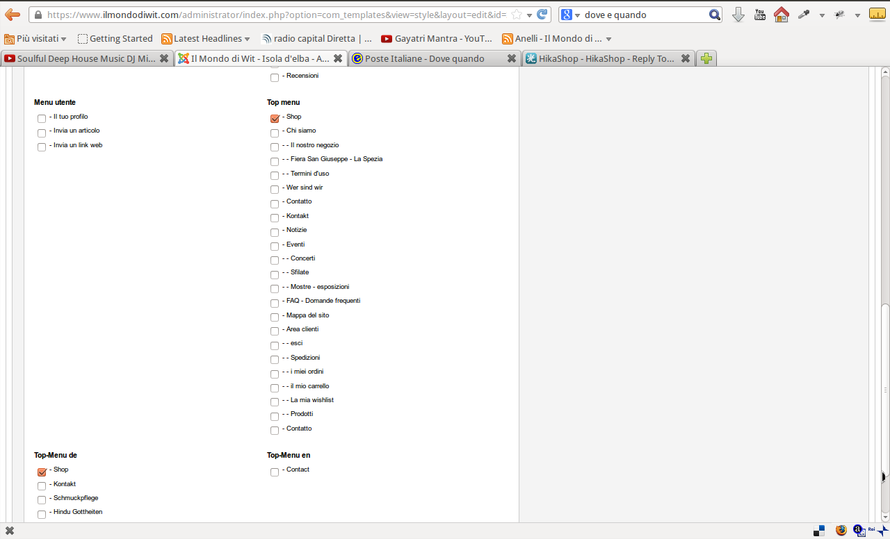

  • Posts: 155
  • Thank you received: 4
12 years 11 months ago #116835
Thanks for reply
Eliot wrote: How do you end to the second page?
If i go browsing from one product to the other using the arrows or if i go from category browsing page. It doesn't matter where i come from. The issue shows on some products. Generally when i copy an older product to get a new one. The products i create new doesn't show that issue.
I think it comes from the page which redirect to this product.
Try to browse in this category from one product to another so you will see that some products are using different templates www.ilmondodiwit.com/shop/artigianali/82...-occhio-zircone.html (start browsing with the left arrow) there are 6 products turning to the wrong template.

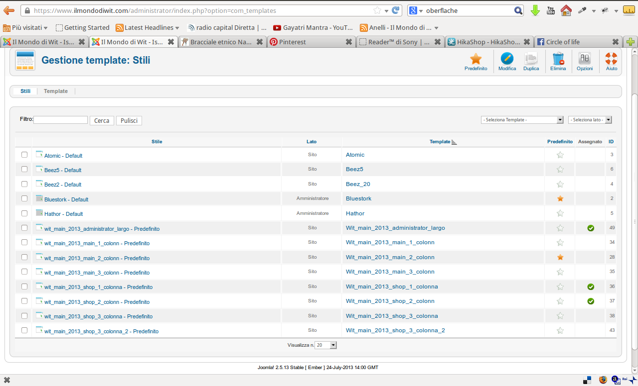

Also, a screenshot of your templates configuration could be useful.
here is the screenshot
Is there somewhere some reference from the product to an menu or module which has references to the templates?
Last edit: 12 years 11 months ago by Cattelan.

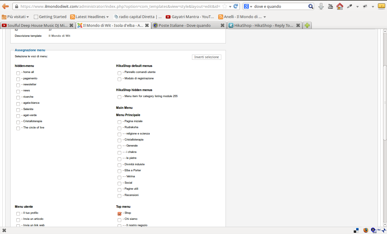

i checked my template settings. The default template i enabled all menus and i diasbled the shop menu.
in the shop template i enabled only the shop menu.
There are no hidden menus or menus assigned to any part or category of the shop !

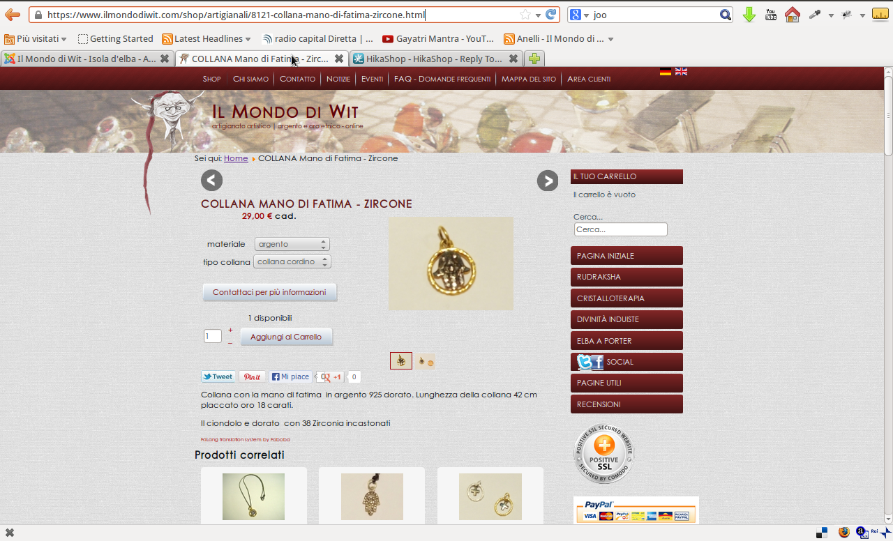

now i try this product to make complete new (before i copied it from an old product) www.ilmondodiwit.com/shop/artigianali/81...-fatima-zircone.html and i attach the screenshot of the actual state.
  • Posts: 155
12 years 11 months ago #116976
no i made this new from the scratch www.ilmondodiwit.com/shop/artigianali/81...-fatima-zircone.html
and it also calls the wrong template and it is only in ONE category

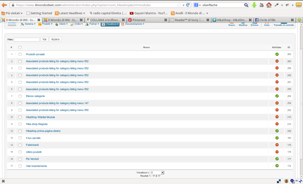

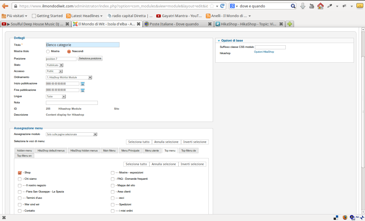

i have the HikaShop Content Module (list of categorys) associated to the shop menu (and only to this) and when the template is changing browsing the products also the module disappears. There is not only a template switch..
this is it how it should be (right template and right module on right position)
This is how it appears on some articles (module missing and wrong template) both template and module are assigned to the menu which is assigned to the hikashop component.
So i think that there is something wrong also with the association from menu an hikashop ??
thanks for your attention
12 years 11 months ago #117310
It seems to be an assignation problem, the modules are maybe not set for the correct menu.
Be sure that the desired modules are set for the shop menu and not other and the other one only for non-shop menus.

12 years 11 months ago #117655
Hi.
Thanks both for reply.
@Xavier this is the setting for the module which shows the categorys on the right side.
@Nicolas, this is the setting for the template which should be affect the shop-menu which is the only existing menu for the hikashop component.
Now what i'm wondering is that i inserted the products which you can find here after opening this topic. i paid attention on every step i made creating them . Some i made new, some i copied. And the result is that some are showing in one way and some in another.

  • Posts: 85860
  • Thank you received: 14101
12 years 11 months ago #117886
I didn't find any difference. Can you give a link to two product pages with the different template so that we can analyze the differences ?
