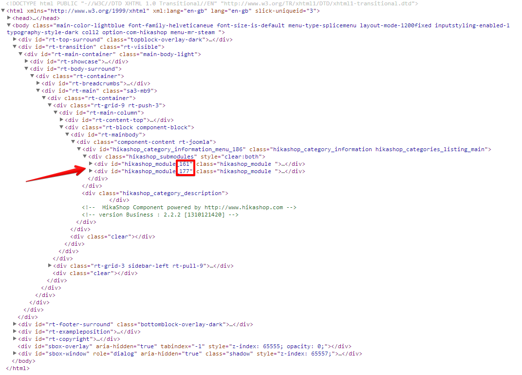

12 years 4 months ago #131967
Your problem is coming from the fact that you have 2 modules which are displaying the same things. the best solution will probably be to control the display of your content modules which have the ID number 161 and 177 by :
- Going to the Hikashop configuration page of this module ("Hikashop->Display->Views")
- Using the "Joomla module options" button
- Using the Module Assignment option.
Last edit: 12 years 4 months ago by Mohamed Thelji.

12 years 4 months ago #131998
how did you determine those id numbers, as i have the problem on several other pages
12 years 4 months ago #132001
I just checked the HTML code of your page, If you don't know how to do that, that tutorial will probably help you :
To do that, you need your browser console or an add-on like “Firebug” for FireFox to see the HTML and CSS of your page.
Usually you have to press the F12 key to have the console show up. You should have something like that displayed:

  • Posts: 223
12 years 4 months ago #132433
Mohamed Thelji wrote: Hi,
still not working...what do i need to change in "module assignment?
  • Posts: 85415
  • Thank you received: 13963
12 years 4 months ago #132438
You need to go in the menu Display>Content menus, edit your menu item ( id 186 ) and in the "associated modules" option, you have two modules enabled (the ones Mohamed pointed out) while you should have only one.
  • Posts: 223
12 years 4 months ago #132440
Thank you!
The previous instructions were a bit confusing, but problem now solved
