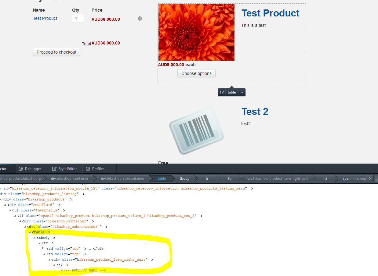

Hi All,
I am using the "div" as the type of layout for my product listing page, however there's still this table in the output which really ruins the responsive layout by making a horizontal scroll bar - does anyone know how to alter this output? I've searched through heaps of the views templates and I can't find it!
Cheers,

It seems like you're not in a product page but in a product listing, you should then edit your content menu/module and then change the type of layout.

Mohamed.. I don't understand your answer.
I think I found my solution though. If I edit the img_desc view template I can remove the table I think.
J
12 years 11 months ago #117629
Ok, so can you just give me a link to the page where you are having your problem ? then I'll probably be able to give more precision about what to do.

Setting the "Type of layout" option of your content module which have the ID number 125 to DIV should works, if not, the problem is probably coming from a product's view file modification through "Hikashop->Display->Views".
