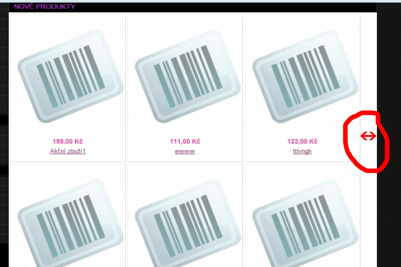

the list of products of my HS is not completely on whole width of the site. How can I make it wide the same as the template? The cart, product details etc are all the full width. Please check the attached file for reference.

You'll be able to do it with some CSS customization, you can give me a link to that page if you want more precision about the CSS code to apply.

Using this CSS code will probably do the job :
.hikashop_products .hikashop_product {
width: 25% !important;

12 years 7 months ago #138770
Did you tried the CSS code that I gave you ? Also, note that you'll be able to use it by adding it through "Hikashop->System->Configuration->Display->Front-end CSS File".

Hi there,
Just add it at the end of the CSS file in Hikashop->System->Configuration->Display->Front-end CSS File and make sure you save this file and use it for the front end.

  • Posts: 95
12 years 6 months ago #141494
Perfect. It works.
