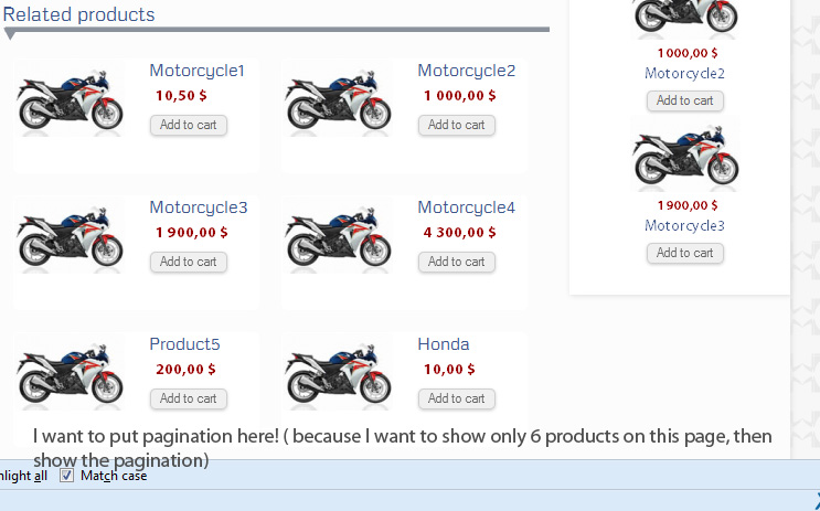

Dear Sir/Madam:
I would like to ask you some techniques that related to pagination.
- I want to put the pagination on the below of products.
( For example, in the HikaShop Content Module,
I want to show only 10 products per page, then show the pagination below the products)
I don't know how to put it. Could you please help me?
Please kindly check the attachment file below to see the place that I want to put pagination

Here is the link: 50.87.134.52/~greenic5/bbs/index.php/motorcycles
I wanna put the pagination the below images because there are more than 14 pictures. I already set the 14 items, but it doesn't show the pagination. I don't know why?

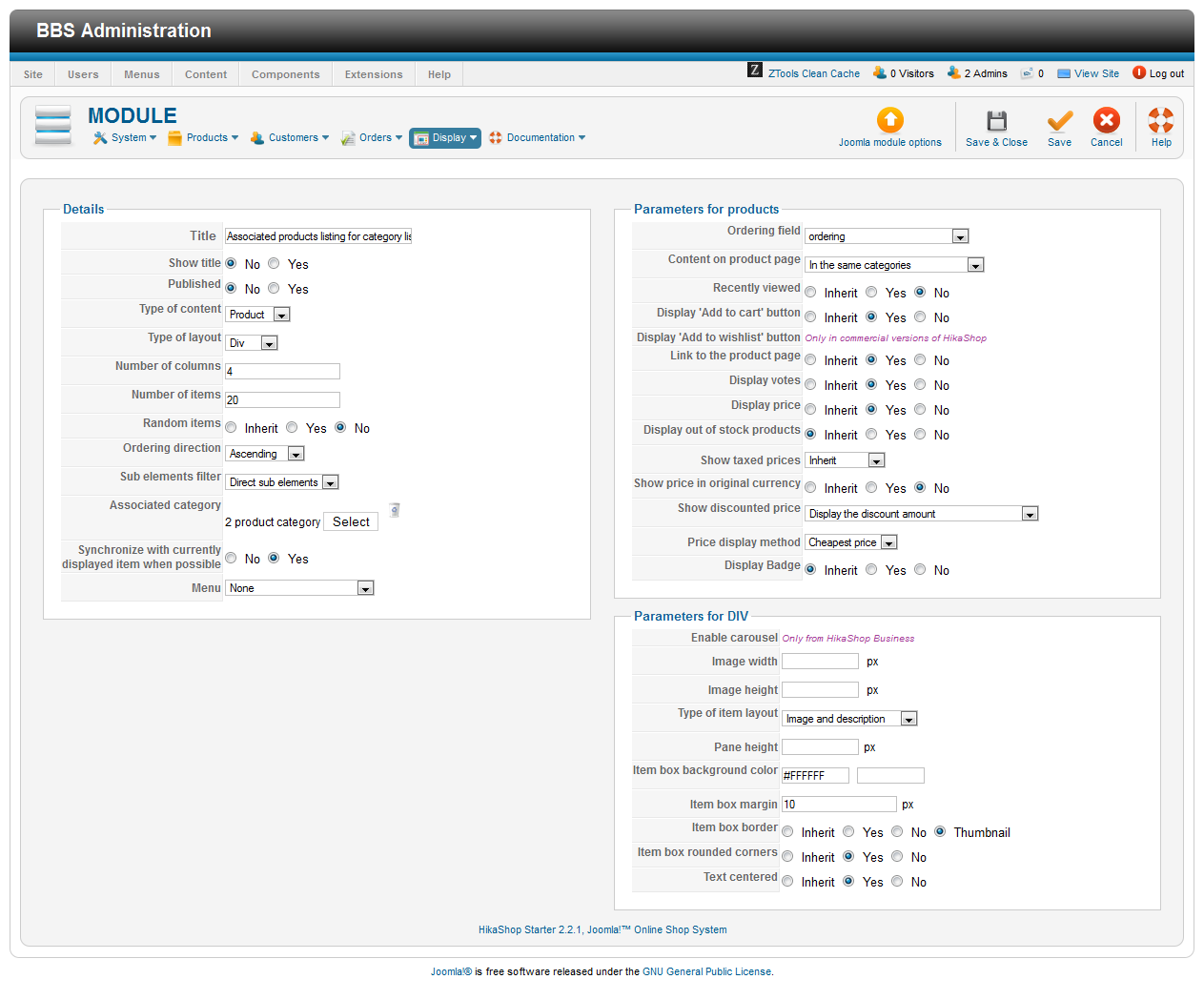

Please provide a screenshot of your HikaShop content module configuration with id "103".

Here is a screenshot of your HikaShop content module configuration with id "103".

Thanks.
So with your configuration, you can modify the HikaShop core in order to activate the pagination for your module. It should not generate any problem.
By default there is no pagination for modules, except for "associated modules" which are displayed under HikaShop menus.
After that, for your homepage, I guess that you can create an HikaShop menu (which includes the pagination) and customize it in order to feet to your requirements. Using the category description or simple view override, you can get the same result (but with a pagination).
Otherwise, it is possible to modify the HikaShop core in order to activate the pagination for modules.
Sometimes a module can be associated with a menu and if there is a pagination for the module (with a linked menu), the pagination won't work properly and will change the menu while changing the page.
The modification touch a view but also a core file which means that you will loose your modification by updating/reinstalling HikaShop.
