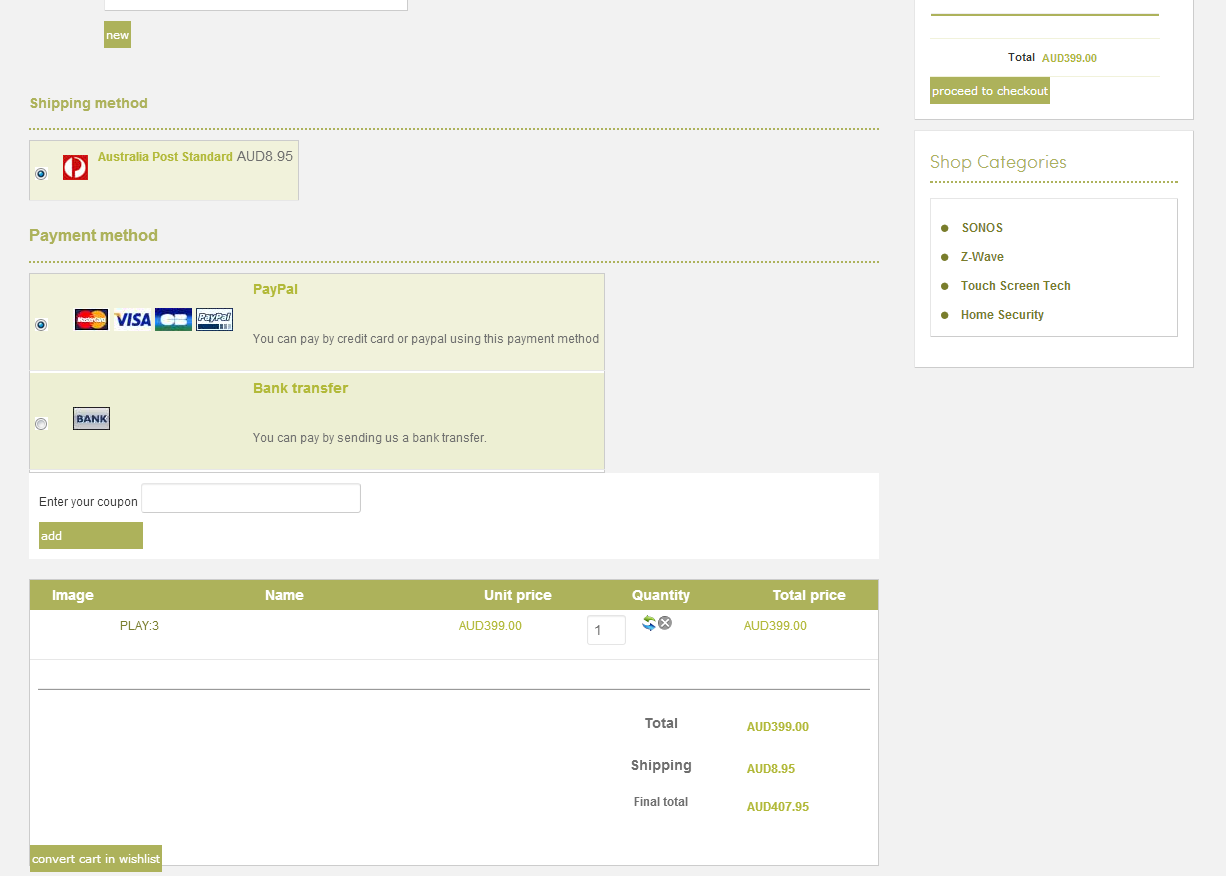

Apologies if this has already been answered (have been looking..) but I'm having trouble with getting my gantry based Joomla template to accurately reflect the green template from your template pack.
I found a reference in another post about removing the comments section from the template .css file in order to get the shipping cart/currency changer header graphics and layout working - which it is now (I was testing with the blue theme earlier which uses a .png for the cart background)
I've since swapped to green and am having trouble with the buttons and possibly the Payment Method/Shipping method layouts.
You'll see from the below screenshot that the buttons aren't styled as per the screenshot from the template pack and I'm pretty sure that the length (width) of the Payment method and shipping method boxes should be wider (to the end of the broken line above them?)
Am having trouble finding where in the .css I should be modifying to fix this - help very much appreciated :)
Thanks,
Damian

12 years 10 months ago #119515
All these buttons have the same class "hikashop_cart_button" so you can edit the frontend css file of HikaShop via the menu Configuration > Display >CSS, and add the properties of your template's buttons to the class hikashop_cart_button.

12 years 10 months ago #119843
I can see that you uncommented the button CSS.
The issue is that your template uses quite a lot of CSS to customize the buttons and the CSS we have in the styles is overridden by your template CSS.
I was able to get the display of the button like in the screenshot by removing all the CSS relative to the classes btn and button in your template CSS via firebug. As the CSS of your template is compressed and cached by the template I can't tell you where you should do the change but that's the solution to get the same buttons. You would have to deactivate the compression/caching of the CSS in the options of the template for me to be able to tell you.
The goal of the HikaShop styles is not to provide the exact same thing as the screenshot that you can see. They are not joomla templates. Their goals is to help you integrate HikaShop display with your template so that it better fits with it. That's why we comment out the elements that are normally styled by the template itself (the buttons and the modules chrome) so that you keep the styling of the template for these elements and only get the styles of the rest of the elements of the HikaShop display.
We actually have some documentation after the installation tutorial to help you uncomment the different things you might want if that's necessary for your template:
www.hikashop.com/support/documentation/i.../113-packstyles.html
Like you did for the buttons, if you scroll a bit down in the style CSS, you will see the CSS for the cart module and other modules also commented out.
