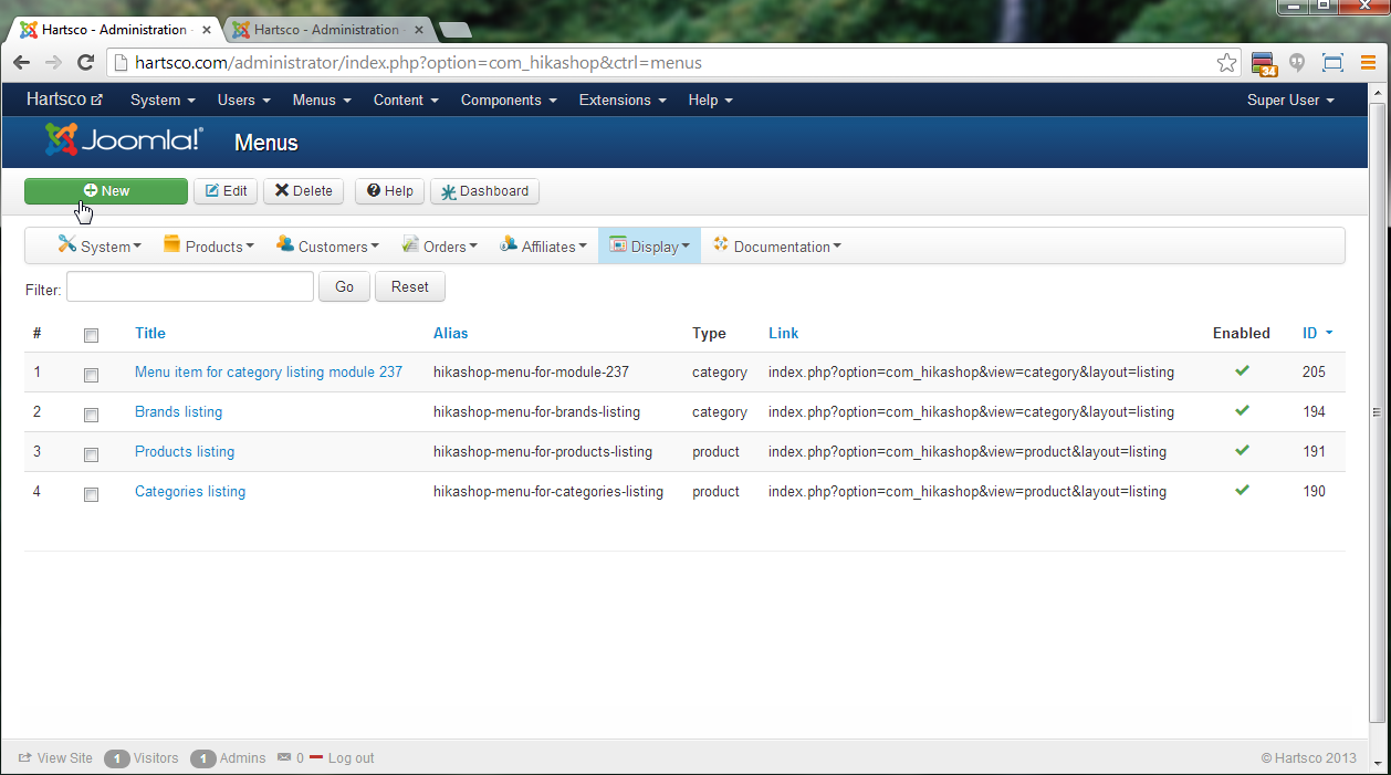

Thanks Nicolas - but I don't seem to have an ID 204?
Last edit: 12 years 10 months ago by damianhartin.
  • Posts: 85860
  • Thank you received: 14101
12 years 10 months ago #120401
If the menu referenced in the URL doesn't exist, then the system uses the default parameters of the configuration, except that there is no default parameter for the title display.
I would thus recommend instead that module from which comes that link is configured to point to a valid menu item. You can do that by editing your module via the menu Display>Content modules and changing the "menu" option.

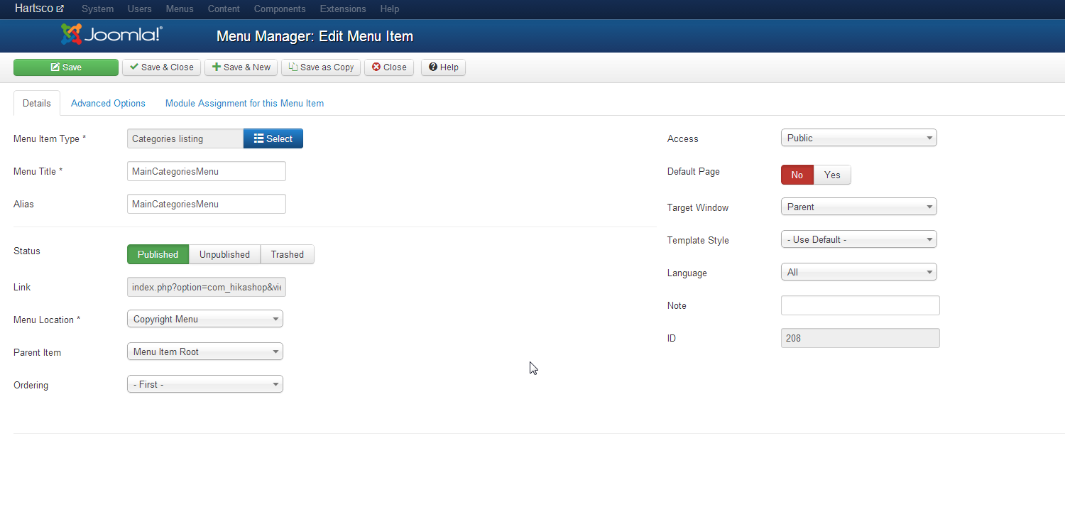

12 years 10 months ago #120520
Ok - so I've created a new Content Menu (MainCategoriesMenu) set the type of content to "Category" and the Associated Category to "2 product category". It then defaulted to an Associated module of "Associated products.... menu 208"
I then set my categories content module (ID:245) to Menu = MainCetegoriesMenu and now I get a 404 not found error?
What have I done wrong now?

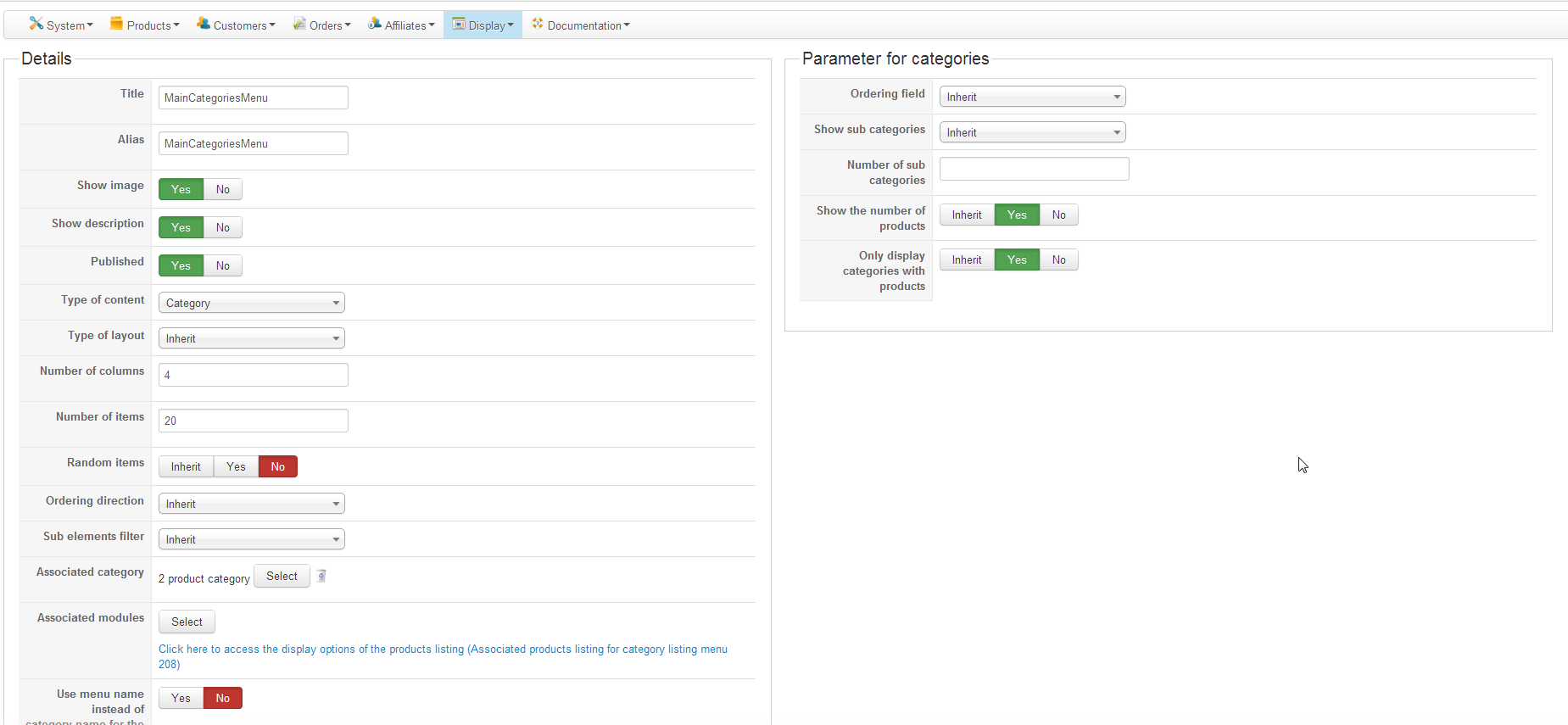

12 years 10 months ago #120522
It apparently comes from the configuration of your menu. Can you do a screenshot of your menu items' hikashop AND joomla options ?
  • Posts: 25
12 years 10 months ago #120524
Screenshots
  • Posts: 85860
12 years 10 months ago #120575
The menu item is correctly configured.
As the alias of the menu is MainCategoriesMenu, that string should be at the beginning of the URL of the links of your categories module of the right (it's actually handled automatically by the SEF system of Joomla).
As it is not the case, it's probably why it doesn't work.

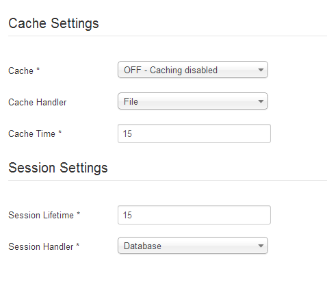

  • Posts: 25
12 years 10 months ago #120587
Yep - no caching set in Joomla - same problem
  • Posts: 85860
12 years 10 months ago #120592
If you have still the old URLs, even though you changed the alias, it means that you still have them cached somehow. Are you sure that the joomla cache plugin is turned off ? The cache options of the configuration ? Any cache setting of your template ?
  • Posts: 25
12 years 10 months ago #120864
All caching is turned off as far as I can see - still not working?
12 years 10 months ago #120983
Thanks to check too the Joomla cache plugin, in the plugins listing.
You can access this listing from the menu Extension > Plugin manager.
