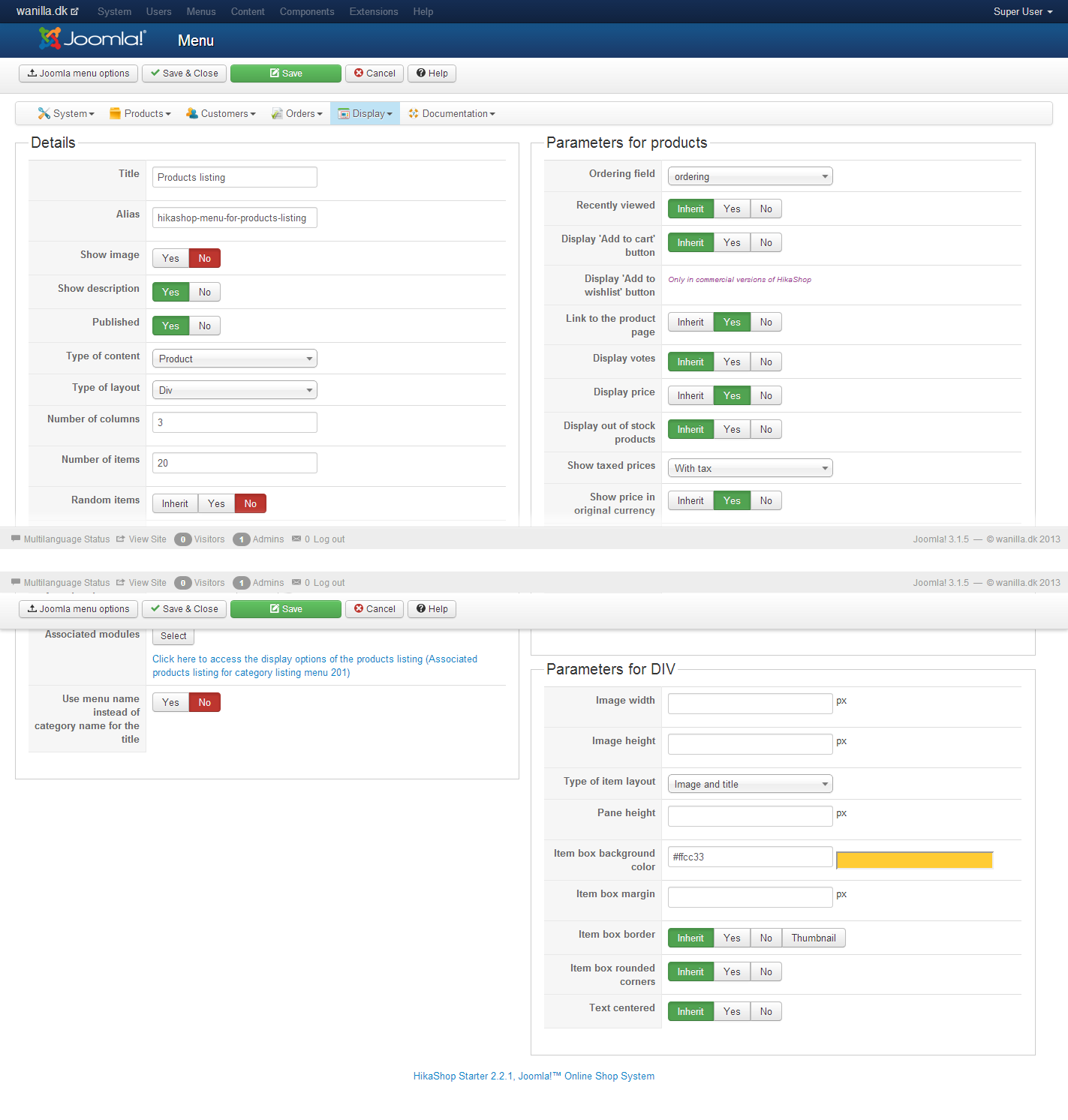

Well, I want a different box color than white, so I went to Hikashop>System>configuration>Display>Default parameters for DIVs.
Set the Item box background color
Then I went to Display>content menus>categories listing and set the Type of layout to DIV. Ok that worked!
I then went to Display>content menus>products listing and set the Type of layout to DIV. Nothing happened!
Why is that?

You can specify the color of the div background in the HikaShop options of the menu.
Display>content menus>products listing >> "Parameters for DIV' herre is the background color option.
As you can see on the picture. I chose Div in the Type of Layout option. I chose the color in the Parameters for Div .
But it is not working?

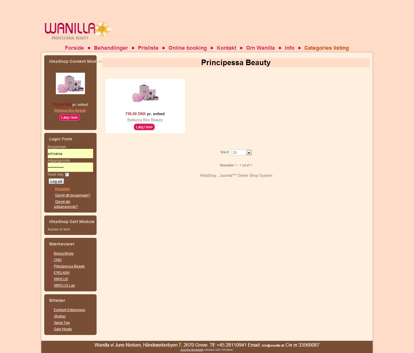

Can you give a link to that page so that we can see that ?

test.ertmania.dk :)

I think that you'll have to :
- Go through your category listing content menu's page
- Use the "Associated modules" link
- And use the "Item box background color" option
Hope this will help a little.
