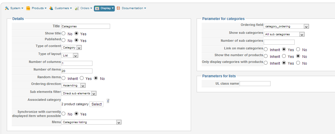

I'm using a HikaShop Content Module in a sidebar, in order to give a categories listing (i.e. a side menu). This works fine at the top level, however, upon navigating down to a sub-category or product, the content module disappears.
Ideally, I would like the full top-level category module to remain in place on all pages. Within Joomla, the module has been assigned to all pages, however, it still disappears when low-level category or product is viewed. In comparison, the Hikashop Cart Module does exactly what I want it to do - it stays in place on the side-bar at all times, it would be great to work out how to achieve the same with the content module.

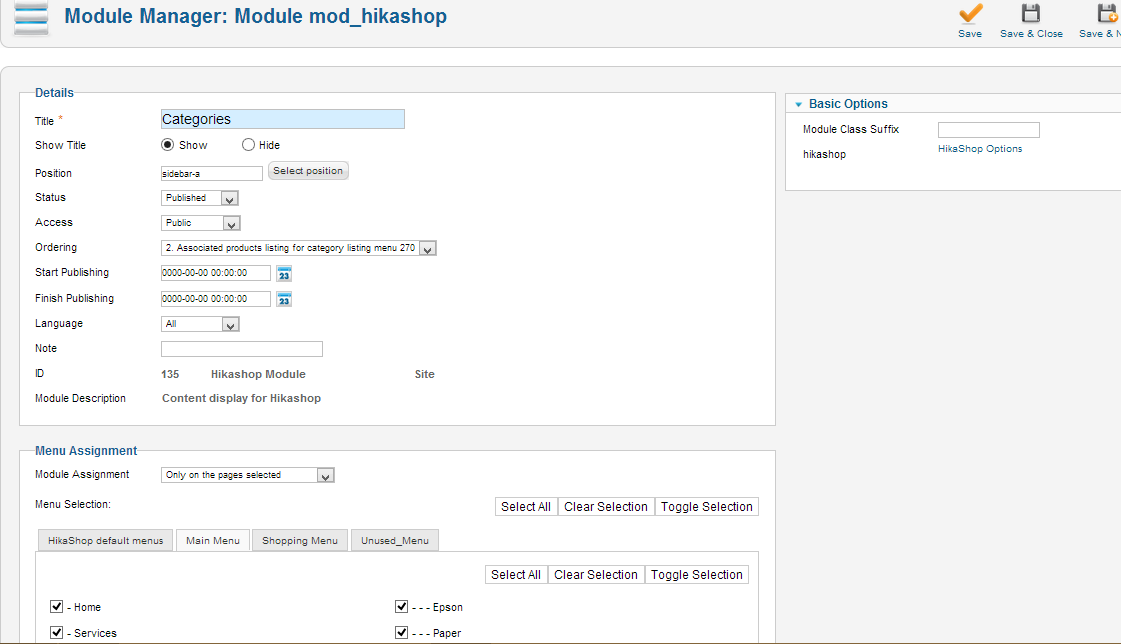

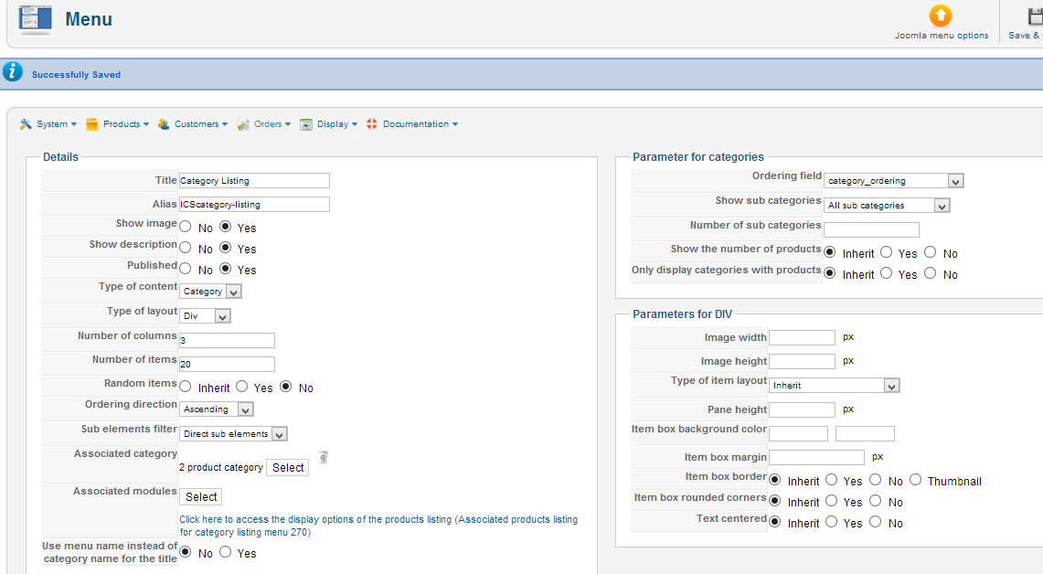

Screenshots attached showing config of the module in -
* Joomla Module Manager
* Hikashop Content Modules
* Hikashop Content Menu
Hopefully this helps and you'll be able to identify the problem.

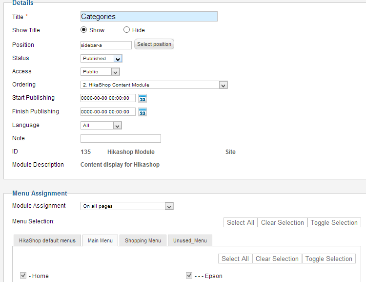

Unfortunately, that is not the solution - the joomla module is already assigned to all pages (see attached screenshot), but the problem still exists. If you visit the site, click on Online Shopping menu and then any subcategory (or top level category with no subcategories), you will see the problem.
Similarly, if you click on a top-level category (for example, Consumables), you will see that the menu automatically changes to the next level and has no clickable links.
Any other suggestions ?

It's because you turned on the option "synchronize with currently displayed item when possible" of your module. Because of that, it always tried to display the sub categories of the current category. And since you don't have sub categories for your categories, there are no categories to display when you select one, and thus you don't see the module anymore.
Simply turn off the option and you will see the module all the time.
