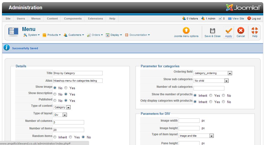

  • Posts: 10
12 years 11 months ago #122316
Thanks for the prompt reply. I checked and that setting was already "Yes" as per the attached screenshot.
HOWEVER, based on your reply I set "Show description" to "No" and applied it, and then set it back to "Yes" and applied it. That seemed to do the trick. Bizarre!
