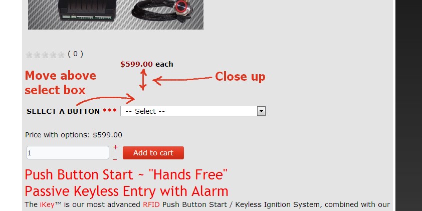

From the image, I need 2 things. Move the "Select a button ***" label to above the drop down selector. Second, close up the big gap between that and the base price (in dark red) above it.
I'm pretty sure the code I need to modify is in the option.php file (at least for moving the label above the select box), but I'm not so sure how to close that big gap up.
12 years 11 months ago #124501
You are right for the view "product | option" and the label/select position.
For your "gap", you have to edit the view "product | show_default". There are some "<br/>" inserted in the page after some blocks (dimensions, characteristics) that are not displayed in your case and which create this "gap".
  • Posts: 279
12 years 11 months ago #124513
Hi Jerome
Thanks for the reply. Gap now satisfactory.
What exactly do I edit, and how, to get the select box on 2 lines? I can see the code (I think), but can't make it 2 lines.
12 years 11 months ago #124659
You have to add "</tr><tr>" between the tags "</td>" and "<td>" to add a new line in the table.
  • Posts: 279
12 years 11 months ago #124752
Thanks Xavier - was trying all sorts of ways and it wasn't working.

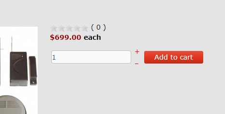

Last thing...I'm seeing that certainly the HS product display is made up of a number of different PHP file - lising_price.php, option.php, etc. I have no doubt there's a good reason for this - maintenance I'm picking. However, it becomes confusing to a "coding tinkerer" like me who doesn't have the skills to follow it all through! :lol:
I want to add a line break between the star ratings (which come from listing_vote.php) and the price (which comes from listing_price.php). You'll see in the image that they're jammed up against each other. Now I know that \n is a line break in PHP, but I cannot figure out where this goes. I've tried a number of spots and it either has no effect or breaks the product listing entirely! :oops:
Can you tell me where to put this, or what I should do please? Thanks.
Last edit: 12 years 11 months ago by trogladyte.
12 years 11 months ago #124808
I think that doing that via some css is not a bad thing ;)
Here is some documentation:
  • Posts: 279
12 years 11 months ago #124934
Brilliant thank you!!
