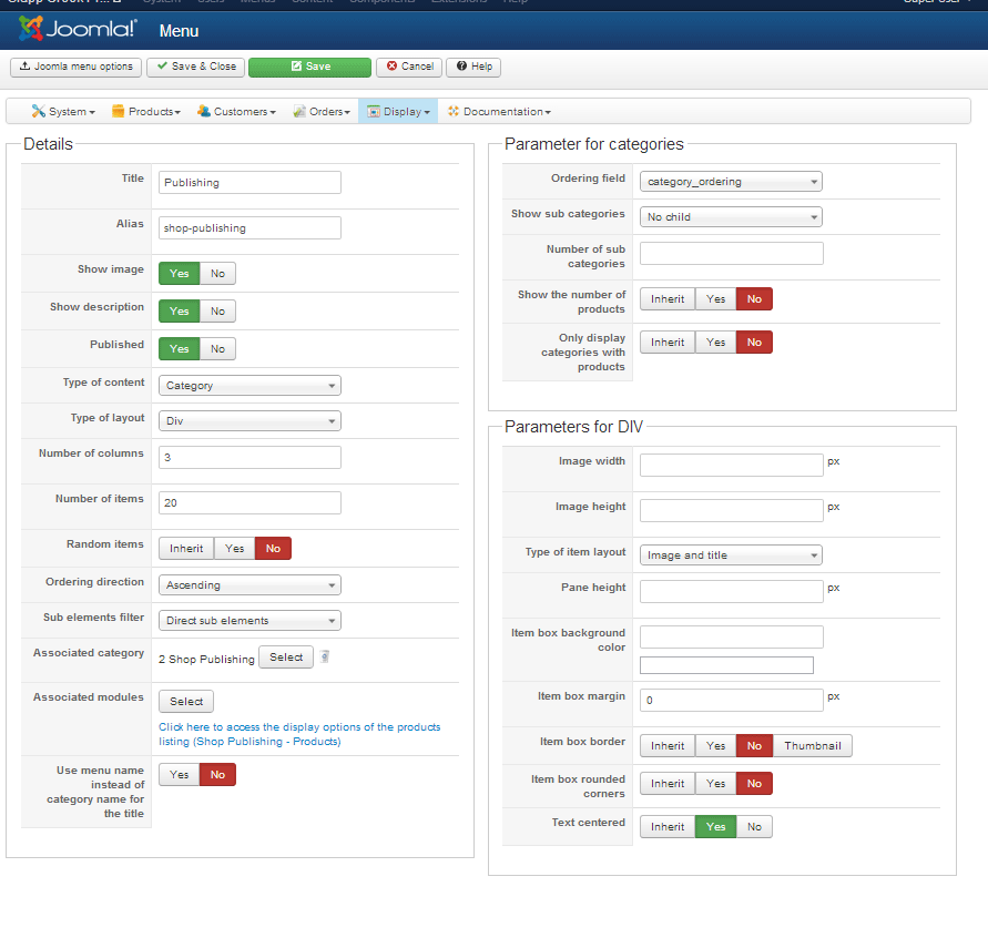

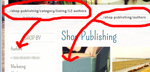

I have been ready a lot about issues with the Content Module category list URL structure, and i have tried many different configurations. I would prefer to avoid 3rd party SEF components.

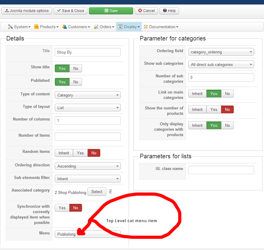

I have created menu links, which created HS menu links and modules. I also have a content module displaying cat's & sub-cat's that points to a HS category menu item. If i visit a category page via a menu link, all is well. When i scroll over the categories in the content, the URL matches the menu, but if i scroll over the module, The same link is not configured. See attached, both link should go to the same page.
The main issue is content module placement per menu pages and individual category options. When clicked, this links lead to a category with many subs. The main category is set to show no image, the subs do show an image. If i click the left nav link, the main category shows an image, but if i click the content link, the category displays as it should per the setting in the HS menu list. If i cannot link to the menu item, i have no control over individual pages.
I am confused why 1 display of a category list outputs the proper SEF URL, but the other does not. Does the content module use a different router then the content?

12 years 11 months ago #125141
The URL shop-publishing/authors is the URL of the menu item authors of the type hikashop category listing and associated with the category authors which is a child of the menu item shop-publishing.
On the other end, the URL shop-publishing/category/listing/12-authors is the URL of the menu item shop-publishing of the type hikashop category listing and associated with your main shop category, with the authors category selected as current category.
Both URLs use different menu items with different things. When HikaShop generates the listing of categories of the shop-publishing menu item, it doesn't know that you have child menu items of that menu for each category of the listing it is displaying so it is using a link which allows it to display the good category while staying on the same menu item.
So to answer your question, the router is the same, however, the non-SEFed URL is different, so the router produce a different URL. Turn off the SEF and you will see how the original URLs are different. On one end you will have a link of the HikaShop joomla menu item of the sub category, and on the other end, you will have a link of the HikaShop joomla menu item of the main category with additional parameters to specify the sub category to display.

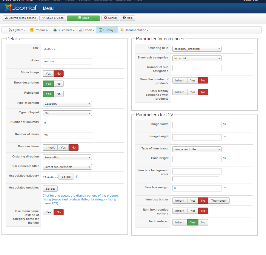

If you look at the options of your menus, you will see that one has the option "show image" turned on while the two others have that option turned off. Turn it on for all the menus and you will always see the image.
Last edit: 12 years 10 months ago by nicolas.

Your first (working) url have the menu id : 249.
Your second (no working) url have the menu id : 241
If you open these two configurations in the HikaShop backend (Display > content menu) you will see some differences.
If you want to have the same render, you have to put the same configuration for the menu 241 than the menu 249.
This option was the "Show image", that I changed for you.
Kind regards,

I was trying to avoid using URL's & the site is currently offline. I have made the site public, but will take it offline after you have another look.
To sum up the issue:
The content menus allow me to choose options for menu links. Theses work well and the Authors link from the menu does not have the category image: www.slappcreekpress.com/publishing/authors
But, the Authors link from the left hand content module has the image: www.slappcreekpress.com/publishing/category/listing/18-authors
What i need is no category image for Publishing & Authors, but individual Authors category images to show. The content module links do not follow the settings from the content menu, so i need to know how to specify which categories show images & which do not.
Or, an option may be to have the category image pull a product image from a sub category, but i do not know if that is possible
  • Posts: 86081
  • Thank you received: 14189
12 years 10 months ago #127438
There is no option for what you want to do. The display options are based on a per menu basis, and not on a per category basis.
So what you configure a menu to display the image of the current category, when you browse the different levels of the categories (you stay on the same menu and thus) you get the same settings and the image displays all the time.
In your module, you configured it to go to another menu and thus all the links of the module go to another menu that your main menu, and that why you don't get the same display options, even though you're displaying the same category pages.
If you want to change that, it would require to always turn on the display of the images in all your menus, and then modify the code at the beginning of the "listing" file of the "category" view via the menu Display>Views to display or not the image based on the current category.
