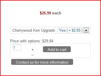

12 years 8 months ago #135229
I now understand this and it works. However, what I think is not good is that it only updates one price field instead of both which is very confusing. Please see image showing 2 different prices.
  • Posts: 86081
  • Thank you received: 14189
12 years 8 months ago #135254
That's normal. The first one it the "base" price without options. The total one is the base price plus all the options price.
I don't see where that would be confusing.
