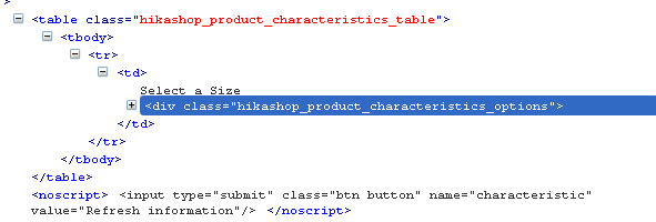

Something is odd :( :( How come I can see the DIV that is around the characteristics but not around the words "Select a Size"?
This is how I edited the code:
'<div class="hikashop_product_characteristics_title">'.$html=$characteristic->characteristic_value.'</div>'.'<div class="hikashop_product_characteristics_options">'.$html.'</div>';
What am I doing wrong please? Please see the screenshot from firebug.

12 years 10 months ago #127715
You code is wrong.
It should be:
$html='<div class="hikashop_product_characteristics_title">'.$characteristic->characteristic_value.'</div><div class="hikashop_product_characteristics_options">'.$html.'</div>';

12 years 10 months ago #127926
Thank you very very very much :)
