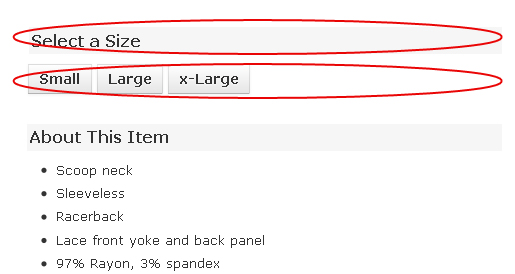

12 years 10 months ago #126442
Oh I may be able to get it to work then without going into the files.
What I was trying to do is get the label across the page and the options below it as per the example attached that reads "about this item". But as you can see it's squished. This is the CSS. I thought adding 100% would make the other td wrap to the next line.
.hikashop_product_characteristics_table td:first-child {
	width:100%; margin-top:20px; margin-bottom:5px; font-weight:bold; background:#F6F6F6; padding:4px 0 4px 2px; }
Thanks!!
  • Posts: 86081
  • Thank you received: 14189
12 years 10 months ago #126445
It's a cell element. You need to change its display type first with something like display:block;

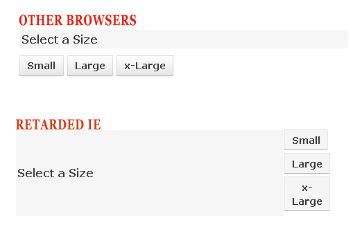

12 years 10 months ago #126557
I got it to work except in IE - this browser is such a pain :( Thanks anyway...
.hikashop_product_characteristics_table td:first-child, .hikashop_product_characteristics_table td.ie7_class44 {
	display:inline-block; width:100%; margin-top:12px; margin-bottom:5px; font-weight:bold; background:#F6F6F6; padding:4px 0 4px 2px; }
12 years 10 months ago #126576
I don't think that IE7 supports the ":first-child" css rule.

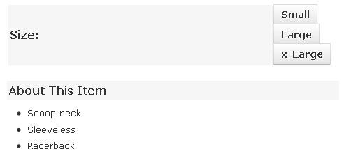

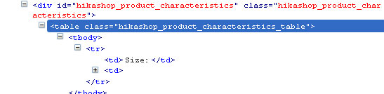

12 years 10 months ago #126578
It doesn't seem like IE8 supports it either 'cause I have IE8 (for testing) and it ignores it.
As per the attached screenshot you can see the difference trying to style the characteristics td :(
Thanks!

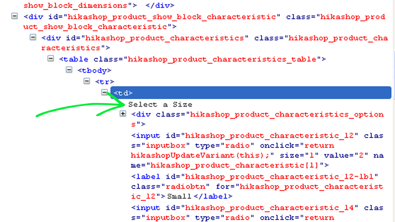

12 years 10 months ago #127578
Thanks nicolas that is what I was referring to.
Really sorry to bother you, but can you tell me which part of the code has the "Select a Size" text? I would like to put a div around that.
Please see the attached pic.
