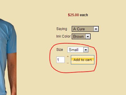

Hi Guys- Please help, I can not find this anywhere! Can you please point me to the line of CSS to edit to adjust the background color of the custom field box and item quantity? I would like to match it to the Joomla template. Please see attached.

Please provide a link to that page so that we can give you the exact CSS.

That CSS should do it:
select#size, .hikashop_product_quantity_field{ background: #BCAF90; }
