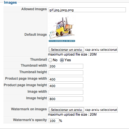

I am using the shadowbox extension and when clicking for an enlarged pop up image I don't get it limited to 800px in height as I have setup in my configuration - Main - Images section.
Shall i change something else to make it effective?

Do you have change the settings after uploading the file ?
Note that if you change these values, the images you already uploaded in your products/categories won't be resized as this process is done at the moment you upload them.
Else you can simply use a free software like xnview to change the size of all you images.

Of course the upload no t taking effect is after the change.
So, what can it be that is not doing the reduction?
Also, to reduce the old files previous to the size configuration, which folder should I look for? There is plenty of images folders for each derivated resolution possible, I don't know where the original non reduced fotos are stored.

The thubmnails folders are used to stored the thumbnails. You can remove them without any kind of problem. HikaShop will recreate them is needed.
The original image is in the media/com_hikashop/upload/ folder

The size set through HikaShop - Configuration - Main -> Image height
is applying when uploading images from the HikaShop component.
But this resizing doesn't get applied when uploading from HikaMarket frontend.
Is this a bug or shall I configure something ? I don't see many settings to be applied in the Hikamarket configuration screen.
12 years 10 months ago #128872
HikaMarket does not have the same upload system than HikaShop and it looks like the option for the image max size is not used during the image upload.
I will see to fix it as soon as possible.
