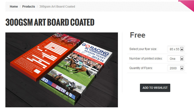

Below on this page i should not be able to select the size 85x55 two sided in 500 qty.
I have the display add to cart for free products set to none and the display out of products set to no.

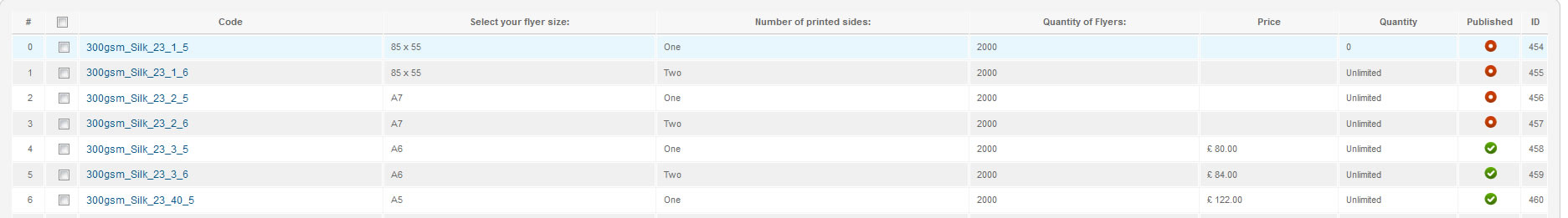

I have attached the variant screen shot showing this variant is unpublished however it is still selectable and the popup says that it has been added to the cart.
hexaprint.co.uk/print-product/429-300gsm-art-board-coated.html

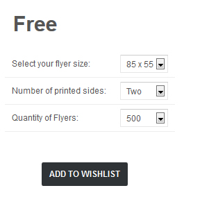

I believe this is what i did already. I unpublished the variant i didnt want to show and then set the display out of stock products to no and have even disallowed wishlist. However i can still see the product and i can click on add to wishlist. Please see attached...
I think quite simply i shouldnt be able to select it from the dropdown if i have unpublished it in the backend. I have even deleted one of the variants and it still shows up. (85x55 one 500)

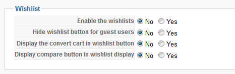

I am still having no luck with hiding the unpublished variants. I have set all wishlist options to no and have unpublished the variant however i am still have to select it. Please see screen shots of my config, the variant and the product page, sorry this isn't making much sense to me, the wishlist option is quite obviously set to be disabled when it is still displaying on the front end..
Alex
12 years 9 months ago #131842
I know that we made some hot fixes in the wishlists for HikaShop 2.2.2, so depending when you download HikaShop, it could be helpful to re-download it.

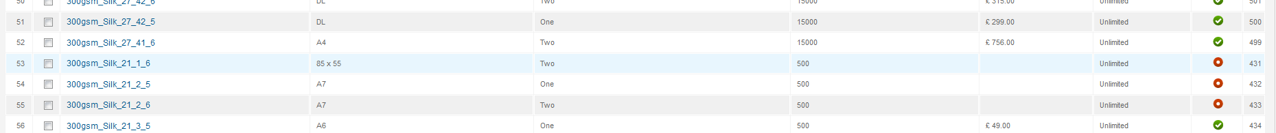

After re-installing 2.2.2 this now hides the wishlist button which is great. For some reason however one of the variants i deleted still shows in the drop down, surely this is not correct? The variant i deleted is 85x55 one sided 500 however it can still be seen on the front end.
Alex
