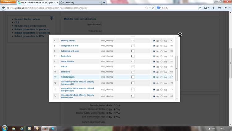

  • Posts: 63
12 years 9 months ago #131957
Every module from the "modules under the product page" option of the configuration is set to no..... please see screenshot
12 years 9 months ago #132038
Is that module used in another part of your website ?
You can try to delete that plugin with the id 217, if it was used somewhere else, thanks to try to create it again.
  • Posts: 63
12 years 9 months ago #132063
Thank you Xavier,
I trashed the module and then deleted from trash - That fixed it :)
