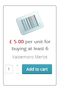

Hi, I am playing around with some of the settings till I get a firm base on how I want my store before I put the whole thing online properly. So I was looking at how I would offer a discount on products if so many were bought which I found that if you put in a new price and a minimum quantity for the price that this does it perfectly!!
Although if there is an option that you could offer 10% off if so much is spent without using a coupon code? Or if for example that 12 assorted bottles of wine were added to the cart that it would automatically discount them 10%?
My current problem is though that when I do put in the minimum quantity for the discount it displays the price like "£5.00 per unit for buying at least 6" and then doesn't even display the unit price.
Is there a way that I can get it to display the unit price and then a discount price, for example:
£5.29 each
£5.00 each for 6+
Thanks, Dom.

1. Another solution can be to :
- Create a coupon
- Set the Minimum order value option
- Set the percentage option to 10
- Use the Product/Category restriction so that you'll be able to apply the coupon on your "discounted products"
- Set Auto load in cart if possible (commercial editions of HikaShop) to YES
2. You'll be able to change it by using the "Price display method" option through "Hikashop->System->Configuration->display"
Hope this will help you a little.
When Changing these absolutely nothing happened to the display what so ever?

Then it means that the options of your module/menu overrides these default options. Edit your menu/module via the menu Display>Content modules/menus and change it there and it will work.
