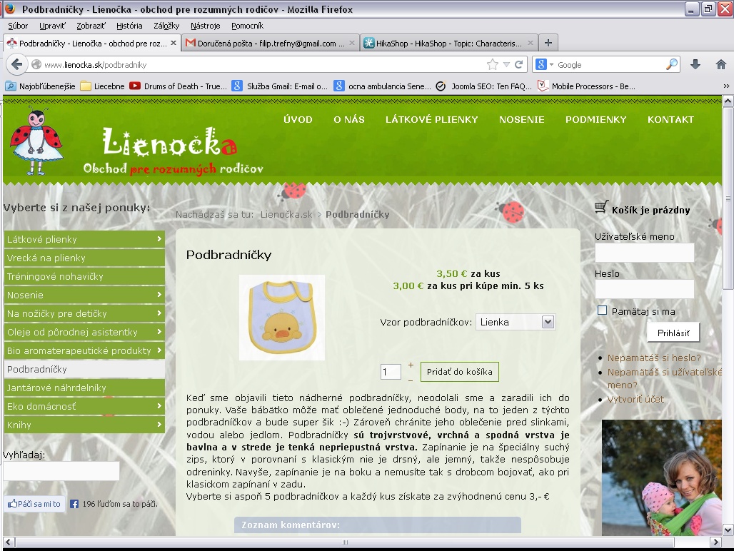

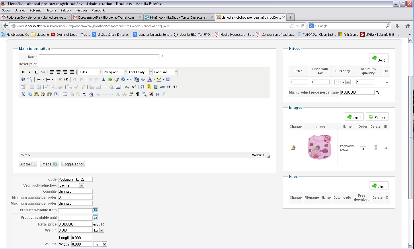

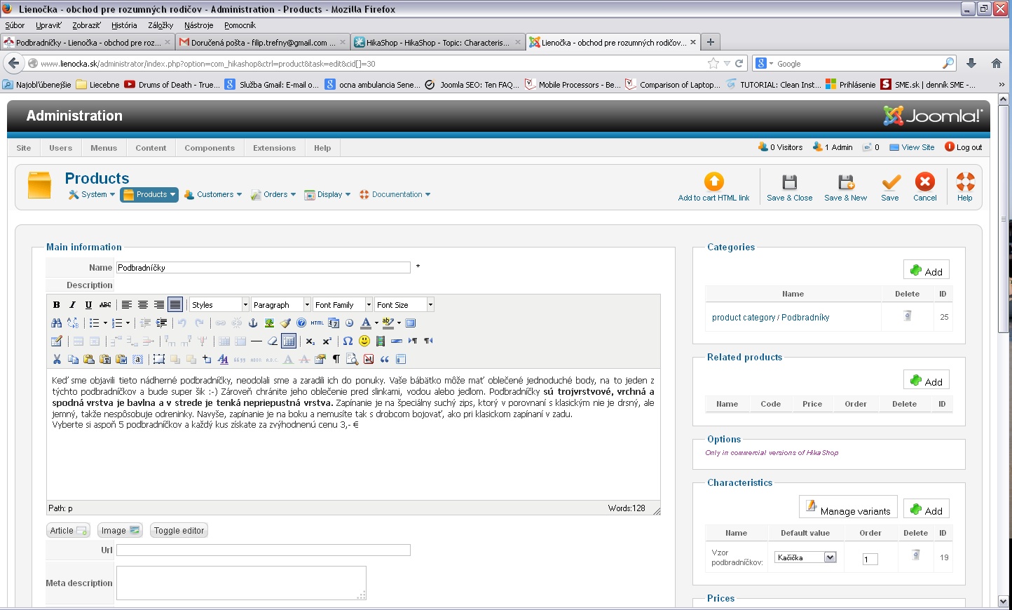

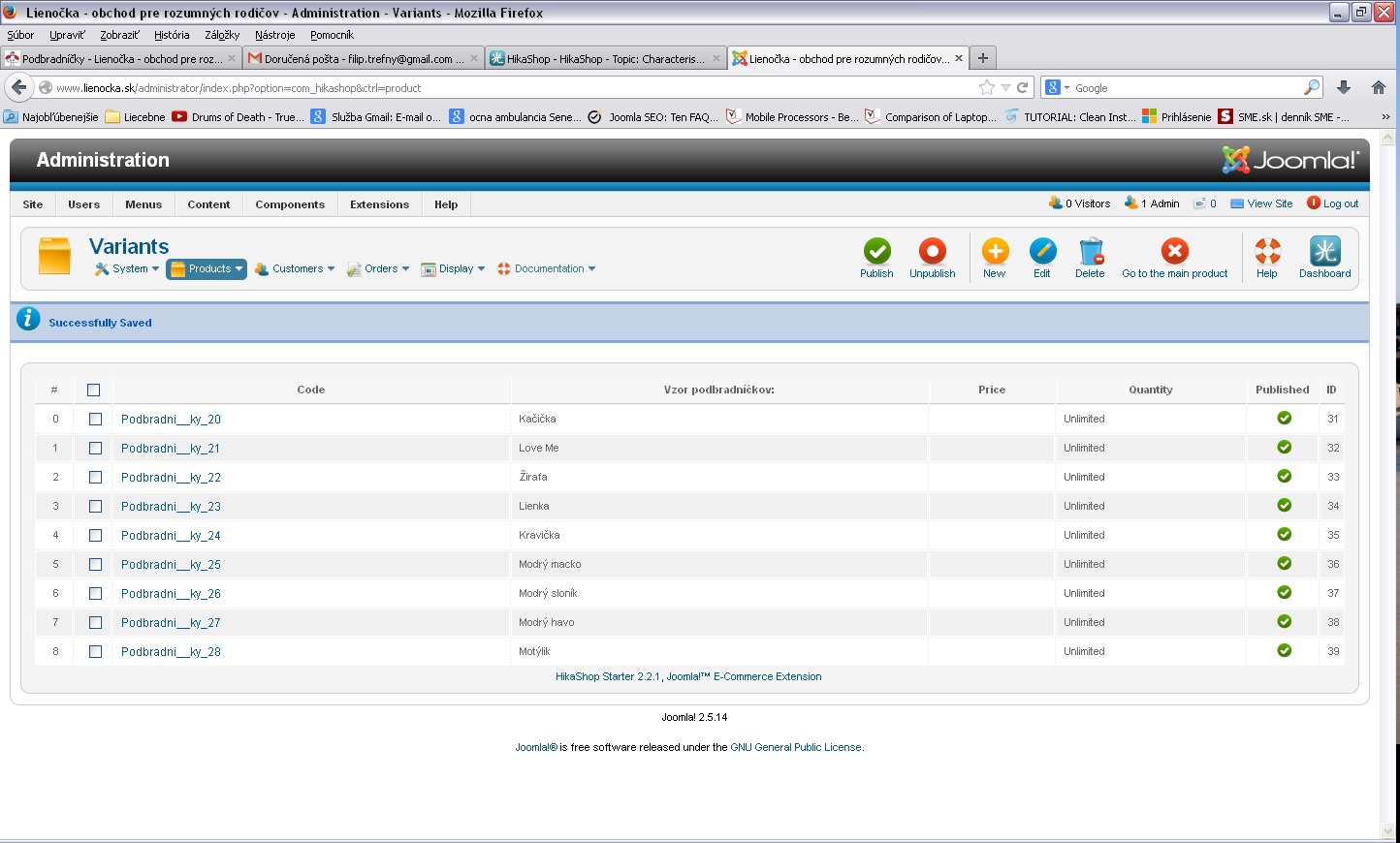

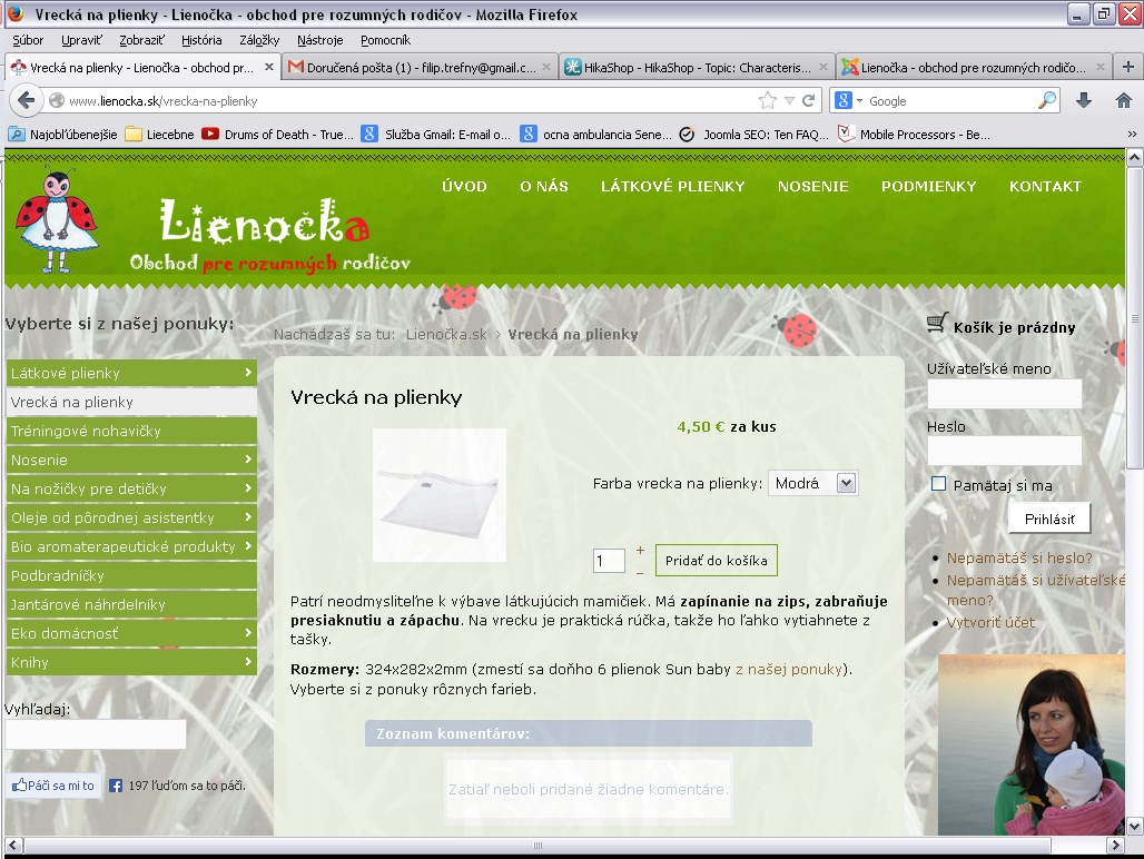

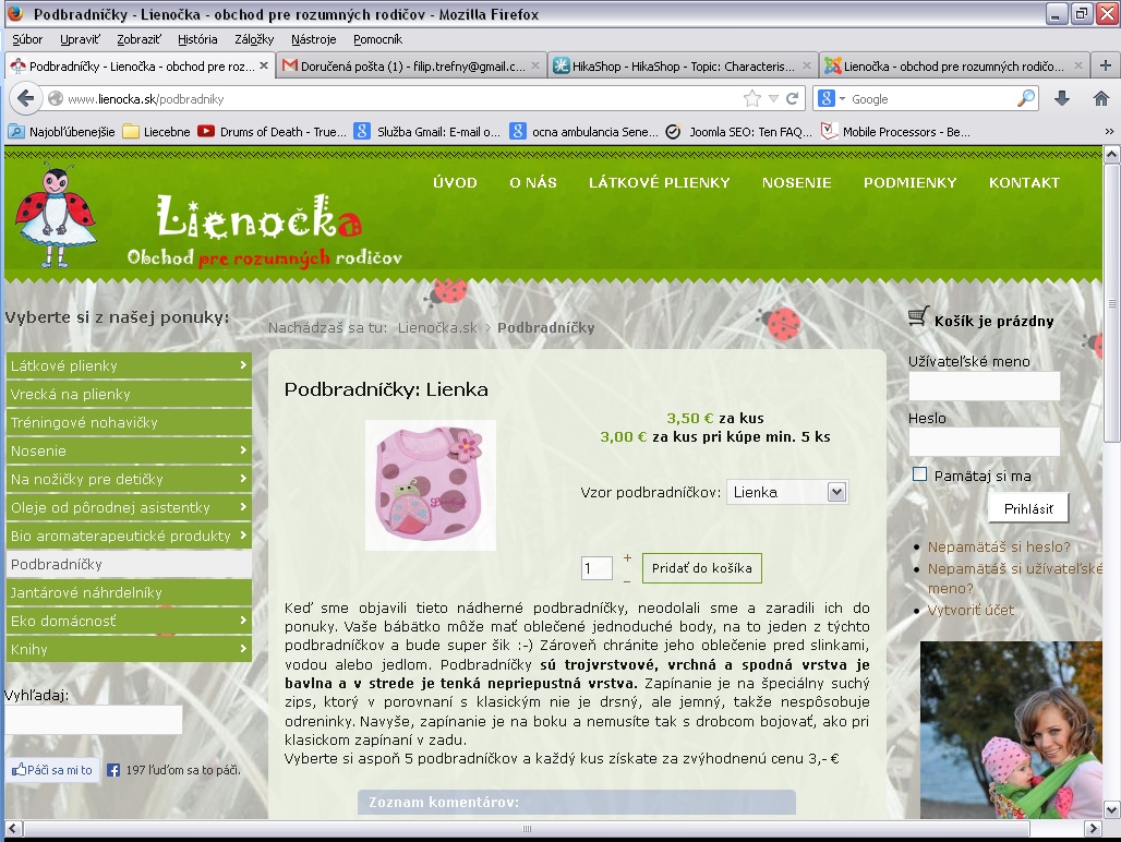

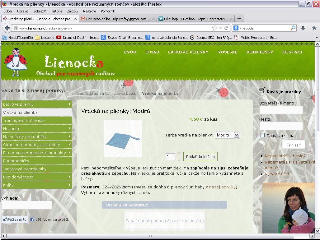

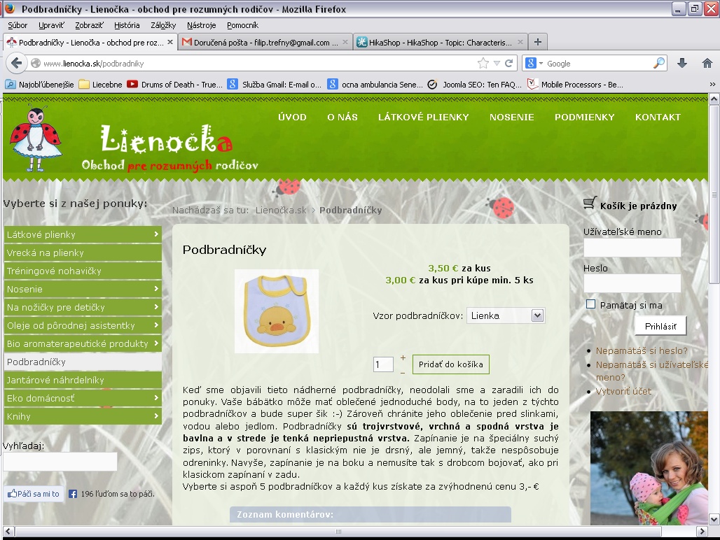

as I mentioned before, the problem is random. Variants for one product are working, and for other product they are not working. After 10 minutes the situation changes, and first product is not working, but the second is.......This happened for example few minutes ago while I was taking screenshots for you. Here are some examples regarding the attached screenshots:
- product "Vrecká na plienky" - variant "modrá" working and also not working ( url: www.lienocka.sk/vrecka-na-plienky )
- product "Podbradníčky" - variant "lienka" working and also not working ( url: www.lienocka.sk/podbradniky )
Hope this will help. Thanks

By "working and also not working" I mean that there are screenshots with working variant (the picture of the product change after clicking on variant), and also screenshots with the same variant not working (the picture of the product does not change after clicking on variants).
