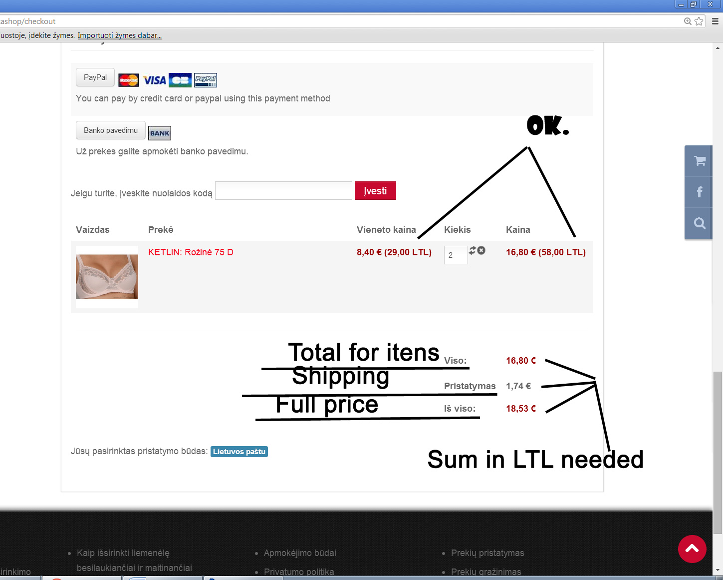

  • Posts: 13
11 years 10 months ago #167688
Jerome, if I understand correctly your suggestion is the same as suggested juremm.
You mentioned "display the original price" option. I’m hanging around and can’t find such option. Maybe you mean “Show price in original currency” (I found it in Default parameters for products), this option switched on, but it can’t solve my problem. If I mismatch something, can you provide path to that option please?
I’ll try to explain again.
For next year (from 2014-08 till 2015-07) I need to display two prices in two currencies “Litas” and “Euro”.
Then I set “Euro” as main currency and leave original currency “Litas”, everything in my site is ok. I can see prices in this format: “10€ (35LTL)”.
But then I try to buy something, auto sum in checkout calculates only in Euros (see pic). Last price (for items, for shipping and for all amount) is only in one currency. But it is not suitable. According to law I must show two prices. Which one is first or last I don’t care, I just need them both.
My original price is in “Litas”, so I can’t set it as main currency, because disappears prices in euros. So I set “Euro” as main currency, and leave enabled original price, and “Litas” enabled in my currency list. If I’m understand correctly, I just need somehow to show two prices in different currencies in the end of checkout. After one year, then “Litas” in my country will be forgotten, and that law will not exist, I just swich off “Litas” in my currency list and that’s it on this case.
  • Posts: 26360
  • Thank you received: 4068
11 years 10 months ago #167698
Okay, I see your problem.
Well, you will have to override some HikaShop views in order to display the price twice.
Like the view "checkout | cart" in order to display the price a second time in the old currency.
Where you see code like that
echo $this->currencyHelper->format($shipping_price, $this->full_total->prices[0]->price_currency_id);
it means that the price is displayed.
You can add some code
echo ' (' . $this->currencyHelper->format( $this->currencyHelper->convertUniquePrice($shipping_price, $this->full_total->prices[0]->price_currency_id, $latis_currency_id), $latis_currency_id) . ')';
to convert and display the price in the other currency.
You have to set the variable "$latis_currency_id" with the ID of your Latis currency (or hard code it).
There are several call of this function (one for each line in the checkout cart) and several views depending what features you are using.
So you might need to override the "cart | showcart", the "order | show" too.

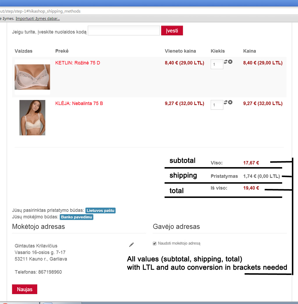

  • Posts: 13
11 years 10 months ago #168211
Jerome, I guess we on the right way.
But again, I can’t achieve good result. I don’t know`why, because of my mistakes or something else. First of all I can say that I don’t need to do changes anywhere else than “checkout | cart”. So if we succeed with “checkout | cart” I’ll be satisfied. :)
I’m not a coder but I tried to do changes. Everything I get is result on attached picture (something went wrong). Its shows old currency just in “shipping line” with no conversion. There was mistake with old currency name (it is “litas”, not “latis”), but I guess the name have no influence (I changed to correct name).
So additional help needed :)

  • Posts: 26360
11 years 10 months ago #168365
@Tamulionyte-Krilavičienė
You have to continue the override of the view for the other elements ; I gave you the shipping line but you have to duplicate the process for the others lines (subtotal and total).
Like I said in my previous message:
Here the subtotal part:
<tr>
	<?php echo $td; ?>
	<td id="hikashop_checkout_cart_total2_title" class="hikashop_cart_subtotal_title hikashop_cart_title">
		<?php echo JText::_('SUBTOTAL'); ?>
	</td>
	<td class="hikashop_cart_subtotal_value">
	<?php
		$this->row = $this->total;
		echo $this->loadTemplate();
		if($this->params->get('price_with_tax'))
			echo ' (' . $this->currencyHelper->format( $this->currencyHelper->convertUniquePrice($this->total->prices[0]->price_value_with_tax, $this->total->prices[0]->price_currency_id, $latis_currency_id), $latis_currency_id) . ')';
		if($this->params->get('price_with_tax')==2||!$this->params->get('price_with_tax'))
			echo ' (' . $this->currencyHelper->format( $this->currencyHelper->convertUniquePrice($this->total->prices[0]->price_value, $this->total->prices[0]->price_currency_id, $latis_currency_id), $latis_currency_id) . ')';
	</td>
</tr>
(Code which can be different depending the options you got about the price display (tax, no tax, discount, no discount, etc).
Here the total part:
<td id="hikashop_checkout_cart_final_total_title" class="hikashop_cart_total_title hikashop_cart_title">
	<?php echo JText::_('HIKASHOP_TOTAL'); ?>
</td>
<td class="hikashop_cart_total_value">
	<span class="hikashop_checkout_cart_final_total">
	<?php
		echo $this->currencyHelper->format($this->full_total->prices[0]->price_value_with_tax,$this->full_total->prices[0]->price_currency_id);
		echo ' (' . $this->currencyHelper->format( $this->currencyHelper->convertUniquePrice($this->full_total->prices[0]->price_value_with_tax, $this->full_total->prices[0]->price_currency_id, $latis_currency_id), $latis_currency_id) . ')';
	</span>
</td>
@arnask
Please follow the previous instructions in this thread.
Last edit: 11 years 10 months ago by Jerome. Reason: code indent
  • Posts: 13
11 years 10 months ago #168382
Hello Jerome,
I’m putting the code as you provided, but it doesn't work for me. After I insert the code, I just get following result:
- subtotal: 10€ (0.00 €);
- shipping: 1€ (0.00 €);
- total: 11€ (0.00 €).
With your code I can see second currency, but it is not Litas, and it is not with calculated rate.
I thing we just have some misunderstanding in our dialogue (because of my English :) , different IT experience and s.o.).
Again – I’m not a programmer (coder). I’m just advanced IT user who can “copy/paste” code, but you must understand that copypasting also can be difficult :) and provide step by step instructions.
When I’m opening “checkout / cart.php” in Joomla! CMS, the code is in plane text, so it is difficult to search and replace. So I’m just: 1. copy/paste this code to Notepade++; 2. adjusting Notepad++ for PHP language to see tags correctly; 3. replacing provided code.
But then I’m confused what I must do with your code. In your first post (there shipping code is) you posted “you can add some code” in the last post “here the (sub)total part”. So what I’m must to do with code? Just add but leave old lines, or replace with old lines?
I mentioned in the beginning of my post, that I tried to put your code, but the wrong result happened. So I can’t understand why, because of bad commands, or bad code replacement.
About php commands. If I understand correctly I need to insert second currency ID to this command "$latis_currency_id". So I inserted ID (91) from my currency list from Joomla! CMS, but it didn’t changed anything. Also my old currency not “latis” it is “LITAS”, but I doubt that the name changes anything because I tried to change it to correct.
Please pay attention to understand the problem.
Again short facts:
- I need to change just “checkout / cart.php“;
- there is no additional options in my site, and I need just basics in two currencies (subtotal, shipping and total);
- I’m attaching php file from my Notepad++, so you can see my mistakes and correct them.
- Also you can try to post clear instruction how to replace/add the code (highly appreciated with php line numbers);
The “Euro law” in my country will be valid from tomorrow, that means from tomorrow I have my business with two currencies Euro and Litas, in toher way my site will be offline for the one year.
Regards.
